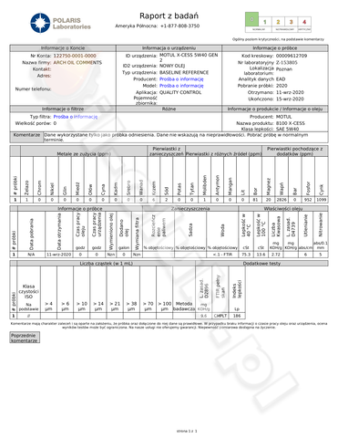

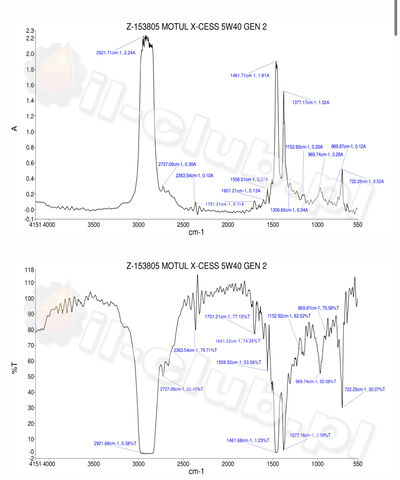

Már volt ahol kapható volt 2 éve. Aztán hogy változott-e valami azóta passz.
1. The oil meets the SAE 5W-40 grade, the viscosity at 100 degrees Celsius, 13.6cSt is in the lower range of SAE 40 (from 12.5 to 16.3 cSt).
X-Cess gen2 has a lower viscosity at 40 degrees C (compared to the previous version), which results in better oil properties at low temperatures.2. Viscosity index VI of 186 has a high value, meaning there is little change in viscosity with increasing oil temperature.
The parameter is typical, although one of the highest for this class of oils.3. The additive package (probably Infineum P6660) is based on ZnDDP (zinc and phosphorus) as the basic anti-wear additive.
Calcium (calcium salicylates) with a small addition of magnesium is responsible for the neutralization of impurities, supported by boron (boron succinomide), which is responsible for the dispersion of impurities in the oil (keeping impurities in the oil mass).
This is a "cleaning" package for oils with an older formulation, typical for A3/B4 (fullsaps) oils.4. TBN 9.6 - is a relatively low, albeit typical, value compared to other oils of this class.
The acid number (TAN=2.72) is relatively high.5. The FTIR spectrum clearly indicates that the oil is based on HC (VHVI) bases. It certainly does not have the addition of groups IV and V.
Summary:
A typical oil from a recognized and respected manufacturer in the ACEA A4/B4 class, 5W-40, dedicated to gasoline and diesel engines without particulate filters, with indirect and direct injection, also with supercharging.
The manufacturer defines it as the second generation (gen2), but comparing the parameters of both oils, it is difficult to find differences.
XCess gen2 is officially approved by BMW LL01. The previous version of the oil only met this manufacturer's standard (or in other words, which parameters were outside the BMW requirements).
Another visible difference is the Viscosity Index (VI).
X-Cess gen2 has a lower viscosity at 40 degrees C, which results in better oil properties at low temperatures. -

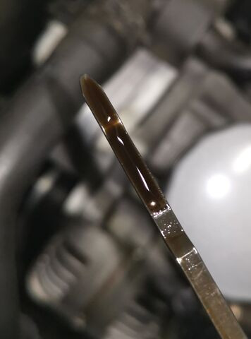

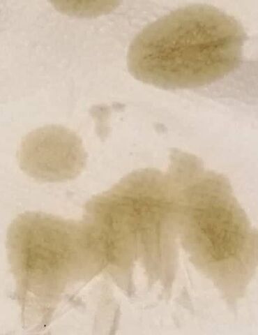

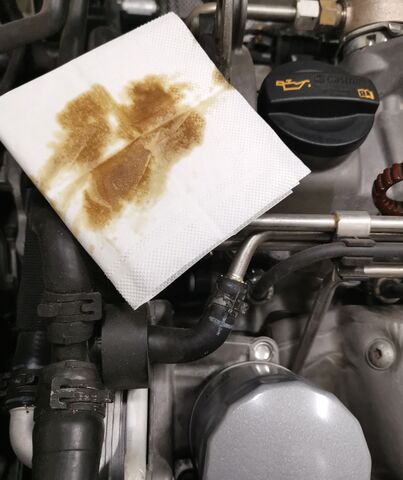

Koszonom szepen, idokozben meg is ejtettem a cseret es milyen jol tettem.
39644 a konyv szerint volt szervizelve, az olaj korom fekete volt barnas arnyalattal ( tudom, hogy nem jelent a szin semmit, az olaj teszi a dolgat de akkor is), az olajleengedo es a filter ugy meg volt tepve, alig birtam leszedni, a 3300 merfoldet futott legszuro, amit a nagy szerviznel ami a fentebb emlitett kellett legyen a konyv szerint kicsereltek.
Azt hiszem ketsegbe kell vonjam, hogy minden meg lett csinalva amit kellett volna.Ideje raneznem a gyertyakra is...

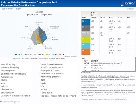

[CS]Blade2 #10209 üzenetére
Ha csupa 1-2-3 km-es ut akkor 4000 utan csereld. Ha mesz hosszabb utakat is akkor a 8000-es periodus is vallalhato.
Ha reszecskeszuros akkor alacsony hamutartalmu olaj kell (C2), illetve a sok rovid ut miatt magas TBN szam is jo lenne (ami nehez ugy, mert a magas tbn szam noveli a szulfatoshamu tartalmat ami meg eltomiti a GPF-t).
Szoval C2-es olajok kozul olyan kene aminek relaitve magas a tbn szama.
Amugy abban van egytalan reszecskestzro.(GPF)? Sztem csak katalizator van benne, oda meg nem muszaj C2-es olaj. API legyen betartva meg a viszkozitas es kesz.
A Motul Eco-Lite 0W20 tokeletes bele amit ajanlottak elottem. -

API service SM, ILSAC GF4 vagy jobb, ACEA A5/B5 *3 --->Ez India, Irán, stb.
majd API SN, ACEA C2 *4
ahol a 4-es, hogy gyakorlatilag az EU-ban ezt kell nézni.Lényegében nekem az lenne a konkrét elképzelésem, hogy a részecskeszűrő szempontjából kapja meg ami annak a legjobb, gondolom ezért is adták meg ezt a C2-t.
Ha csak azt nézem, hogy API SN, akkor nem megyek el az EU-s szerintiben mondjuk a C-nél a C5-re pl.? Szóval olyan nincs, hogy ezen a terméken ugyan nincs ACEA jelölve, de, ha vizsgálgatnánk, akkor leginkább nem a C2-be lenne sorolhatóPapíron egyébként nekem a 6 havi cserét írja a könyv, mert mindig csak rövid utakat megyek,
csak abból is az átlagos felét, szóval 7500km vagy 6hó, és ugye amelyik előbb eljön, ami ugye nekem még így is bőven a 6 hó lenne.
