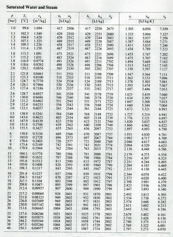

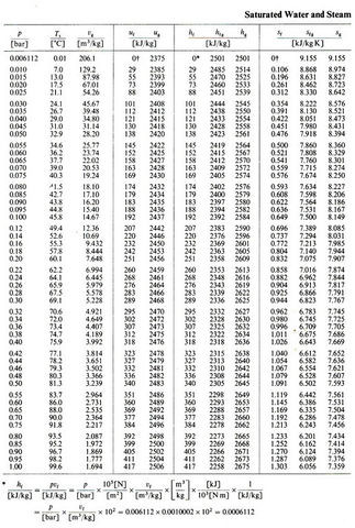

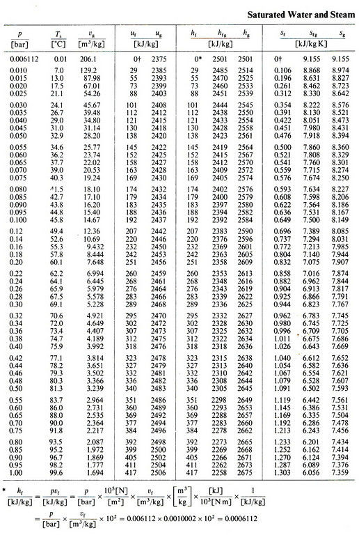

fragola.6035
#55230
Fragola:
hibáztam. jó néhány dologban...a gép e61 hx termoszifonos egy bojleres lascala butterfly
1. hiba: a hőelem kábele normál réz kábellel meg lett toldva. nem gondoltam hogy az nem jó, mostmár tudom, mert utána olvastam....
2. elővettem a gyári vezetékes k-tipusú hőelemeket, és azokkal fogok mérni egyet
3. a táblázatok amiket linkeltem, 2 v 3 éve találtam a coffeesnobs.com.au fórum - Boiler pressure as water temperature témájában
idézve a cikkből:
"Now how to read this information.
The pressure, in Bar, is absolute, that is, it is measured from zero pressure, so the one bar line is just below one atmosphere in pressure, one atmosphere (normal pressure) is 1.01325 bar (14.7 PSI), which is added to the gauge pressure to get absolute pressure, clear as mud?One bar is 100 KPa, or 14.5 PSI, if you look at the one bar line, the temperature of the water will be just under what is considered boiling point at one standard atmosphere, 99.6 degrees C.
So another way of looking at this it to see it as the temperature it will boil at for the pressure, hence the "Denver affect" of not getting a good coffee in Denver as it is too high, and the pressure is .835 bar or 12.1 PSI, and the boiling point of water at this pressure is roughly 94 degrees C.For most Heat exchanger machines, like my Giotto, the boiler pressure is displayed.
This has a relationship to the temperature of the water in the thermo siphon itself.
In the case of my Giotto, when new, was a displayed pressure of 1.1 bar, which is a temperature of 122 degrees C, roughly (how much do you trust the gauge?).
Over time (years) this crept up to 1.3 bar (125 degrees C), until I extracted my digit and adjusted the pressure stat that turns the element on and off, down to 1.1 bar again."Ha kell le is fordíthatom az egészet, de a lényeg:
a táblázatban szereplő értékek zéró nyomástól mért értékek, azaz a kijelzőn olvasott értékhez még hozzá kell adni egy atmoszféra (légköri) nyomást, ami 1.01325 bar....remélem mindent megvilágosítottam....
tehát ha a kijelzőn 1.1 bar nyomás szerepel akkor a bojlerben lévő vízgőz nyomása 2,1bar = 122C lesz....a zuhany / felsőszűrő általános és elfogadott elnevezés. Mindkettő a funkcióját mutatja, ráadásul az angol terminológia csak showerscreen-ként hivakozik rá....
nyomás alatt zuhanyként, nyomás esés esetén meg szűrőként funkcionál.... -

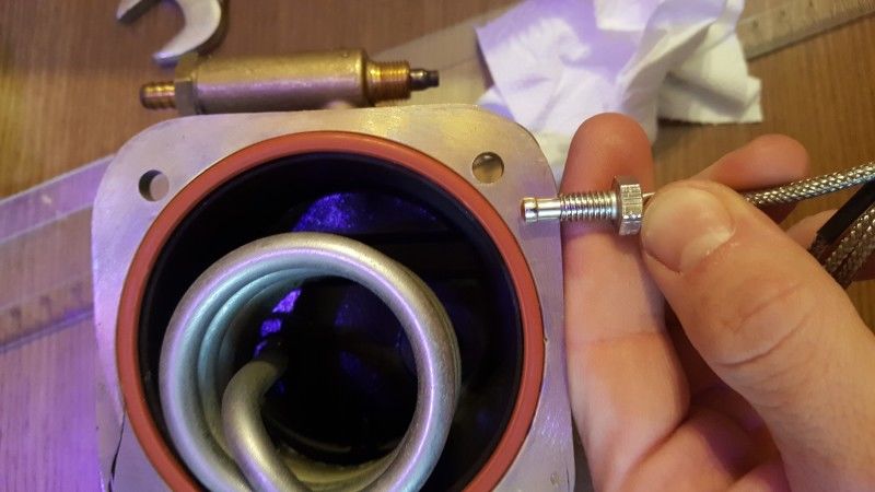

Kedves Fórumtársak!
Picit bajban vagyok újonnan vásárolt PID-em (köszönet érte SzuMe kollégának) K-elemének elhelyezésével.
Adott a berendezés: Isomac Supergiada, ami alapvetően a bojler tetején méri a hőmérsékletet.
Triviális, hogy ide nem akarom tenni sokkal inkább alulra, minél közelebb a felső szűrőhöz.Mit tudnátok javasolni, hogyan rögzítsem a kis aranyost?
A megjelenített képen látható egy nagyobb falvastagságú rész (8-10 mm), esetleg oda gondoltam készíteni egy menetes zsákfuratot, de így az előmelegítő csövezésnek lenne kevesebb helye.
Másik gondolat, hogy a bojler osztósíkjában elhelyezni egy zsákfuratot, amibe konduktív hőátadásra képes pasztával rögzíteném. Így elférne az előmelegítő is.Erről mi a véleményetek?
Köszönöm előre is a hozzászólásokat!

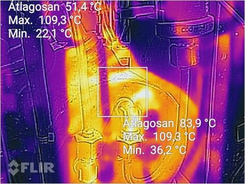

debsa
Tegnap este Miroval beszélgettünk az e61 hőstabilitásáról.
Eddig valamiért nem csináltam róla mérést, de ezt most pótoltam....
Az infúziós csatorna végén található szervizcsavart eltávolítva, egy hőmérő segítségével, pontosan nyomonkövethető az egész felmelegedési folyamat....
Valamikor szétkapom a pöri vezérlését is, és artisan-al készítek egy logot, a hőfok változásról, egyenlőre csak egy-egy shot hőstabilitását lehet nyomon követni.
Meglepő volt számomra, hogy mennyire stabil; gyakorlatilag 0,1C csökkenés volt a shot elején, ami nem sokkal később vissza is állt a kiindulási értékre.
Utána természetesen el kezdett hűlni, ami kb -5C volt
A bojler hőmérséklete 1,1bar / 109,3C volt, ez a fejben 94,7C-ot jelentett
Egy lista a nyomás és hőfok összefüggéseiről:
Két videót is készítettem, a rendszer stabilitásáról.
Az első videó közvetlenül a bekapcsolást követőt felmelegedés utáni első csapolás hőingadozását hivatott demonstrálni:
https://www.youtube.com/watch?v=KLlB0zHXV0EA második videó egy hőkamerás felvétel arról, hogy mennyivel csökken a folyadék hőmérséklete, miután áthalad az őrleményen és a szűrőtartóból a csészébe érkezik.
https://www.youtube.com/watch?v=j0mATWSYM4gAz E61 hx/thermosyphon témában írtam ehhez egy cikket, akit érdekel olvassa el.
