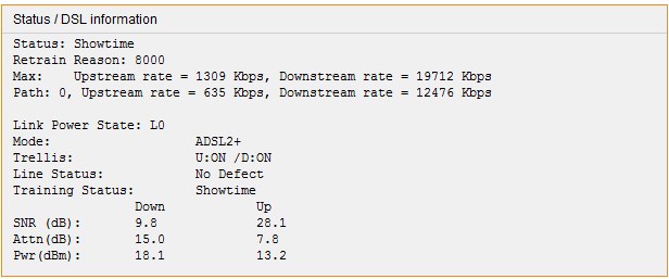

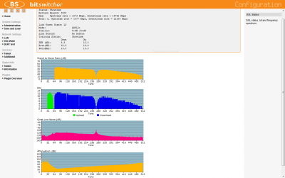

MPeter87
Az info kimenete:
Status / DSL information
Status: Showtime
Retrain Reason: 8000
Max: Upstream rate = 1344 Kbps, Downstream rate = 18236 Kbps
Path: 0, Upstream rate = 1085 Kbps, Downstream rate = 14332 KbpsLink Power State: L0
Mode: ADSL2+
Trellis: U
N /D
N
Line Status: No Defect
Training Status: Showtime
Down Up
SNR (dB): 8.1 16.5
Attn(dB): 12.0 7.5
Pwr(dBm): 18.3 13.3
ADSL2 framing
MSGc: 92 29
B: 36 63
M: 1 2
T: 8 1
R: 10 16
S: 0.0823 3.7161
L: 4567 310
D: 384 8
Counters
SF: 5407 5439
SFErr: 0 0
RS: 4239188 93649
RSCorr: 0 0
RSUnCorr: 0 0HEC: 0 0
OCD: 0 0
LCD: 0 0
Total Cells: 2921541 1040195600
Data Cells: 7176 4087316649
Drop Cells: 0
Bit Errors: 0 16774ES: 5 22
SES: 1 3
UAS: 85 2472
AS: 87INP: 3.36 1.65
PER: 16.13 16.25
delay: 7.90 7.43
OR: 48.58 17.22Bitswap: 6 1
Total time = 1 days 11 hours 15 min 27 sec
SF = 13210786
CRC = 455
LOS = 1
LOF = 9
ES = 5
Latest 1 day time = 11 hours 15 min 27 sec
SF = 2508272
CRC = 452
LOS = 1
LOF = 9
ES = 2
Latest 15 minutes time = 27 sec
SF = 1741
CRC = 0
LOS = 0
LOF = 0
ES = 0
Previous 15 minutes time = 15 min 0 sec
SF = 52521
CRC = 451
LOS = 1
LOF = 9
ES = 1
Previous 1 day time = 24 hours 0 sec
SF = 5354241
CRC = 2
LOS = 0
LOF = 0
ES = 2
15 minutes interval [-30 min to -15 min] time = 15 min 0 sec
SF = 55817
CRC = 0
LOS = 0
LOF = 0
ES = 0
15 minutes interval [-45 min to -30 min] time = 15 min 0 sec
SF = 55755
CRC = 0
LOS = 0
LOF = 0
ES = 0
15 minutes interval [-60 min to -45 min] time = 15 min 0 sec
SF = 55754
CRC = 0
LOS = 0
LOF = 0
ES = 0
Showtime Drop Reason: 8000
Last Retrain Reason: 8000 -

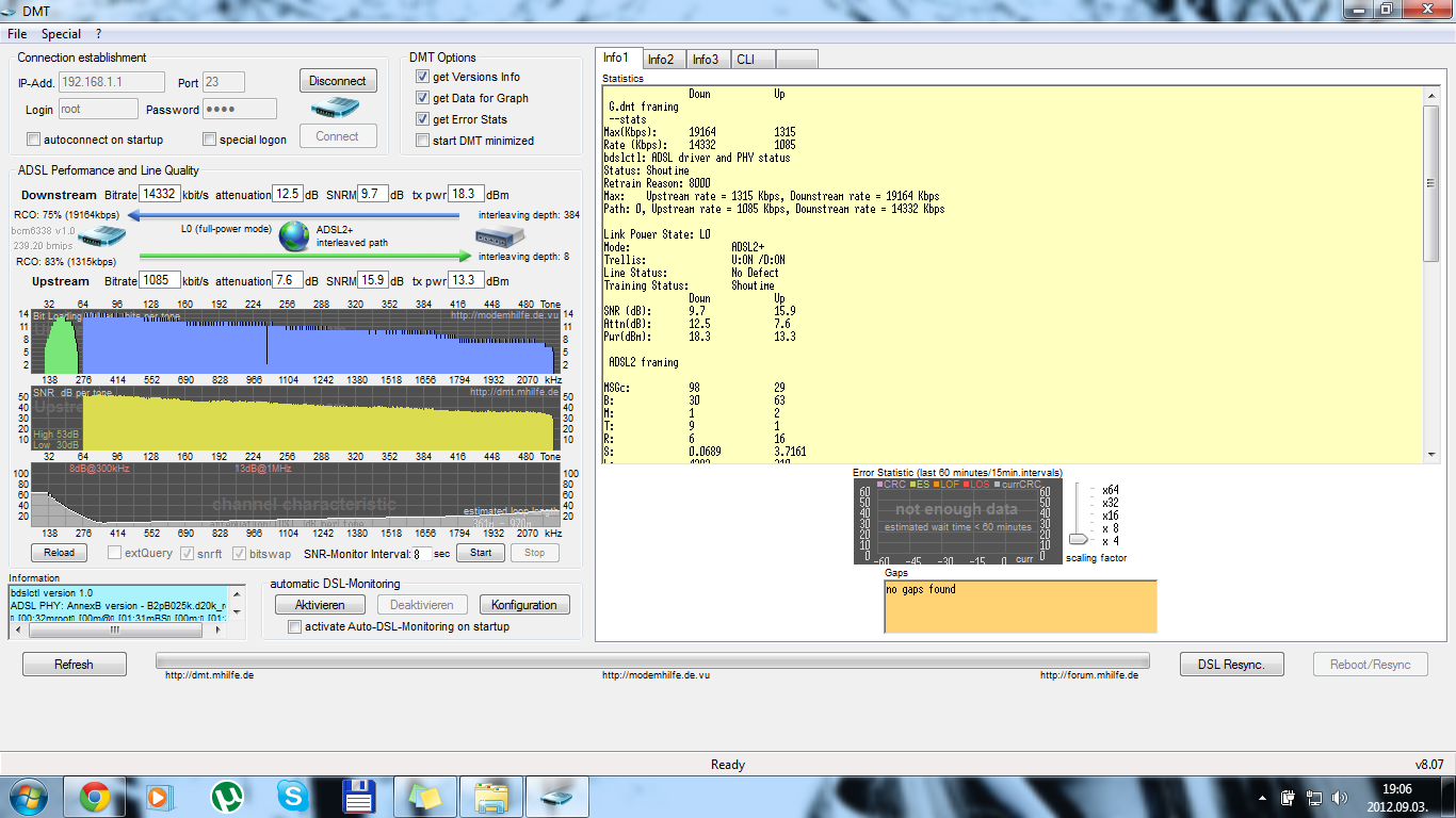

MPeter87
1-2 alkalommal megvolt az áramtalanítás, ill kikapcsolás, mert furcsán nem akart magához térni szegény, de bízom benne, hogy ettől függetlenül hasznosak az infók.
(Szerk.: megcsináltam az SNR tesztet is közben, csak filmnézés közben elfelejtettem leállítani a 3 kis kocka utána, úgyhogy arról is tudok beszúrni valamit, ha kell
)Az info teljes kimenete:

dchard
MPeter87
#1485
Mindkettőtöknek:
A matek jó, csak hiányos a képlet.
1. A mért letöltési sebesség a hálózati protokolok overhead-je miatt 10-15%-kal kevesebb a névleges sebességnél. Például ha 15.000kbit/s a letöltési irány a fizikai rétegen, akkor például a speedtest-tel örülhetünk ha 13megát kimérünk, pedig valójában a dróton ekkor is 15megányi adat megy, csak ezek egy része számunkra nem hasznos adat (habár ezek nélkül nem működne maga a kapcsolat sem).
2. Valószínűleg a magas csillapítás miatt alapból sem éri el a vonal a maximális sebességet. Ez majd a diagnosztikából kiderül.
A routernek ehhez nincs köze.

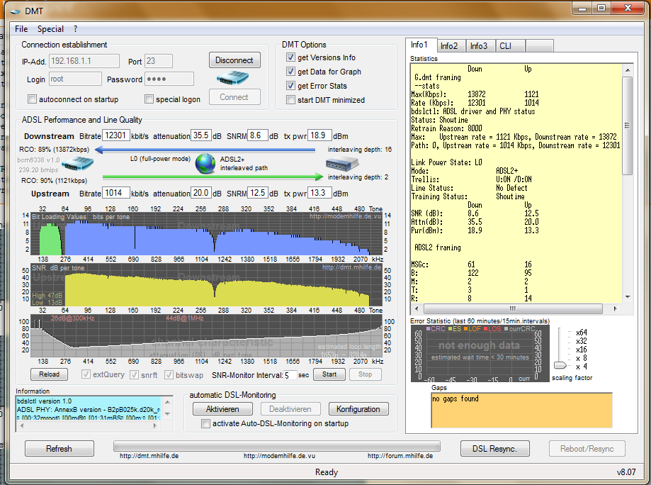

mennyire csökkentsem az SNR margint? -
dchard
eastsider
#1466

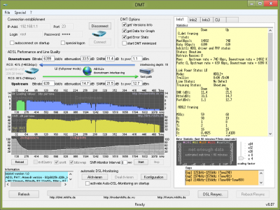

A vonal rendben van, a bithiba arányokat kéne megnézni:
DMT-s képen a jobb szélen lévő szöveges adatokat kéne kimásolni.
Az 5 mega nettó hülyeség (mint általában). Ez a vonal kb. 13-14mega szinkron sebességet tud. Ha alacsonyak a bithiba arányok, akkor lehet esetleg picit csökkenteni az SNR margint és nyerni még egy megát.

a broadcom chip éget...
dchard
Szokenesz
#1464

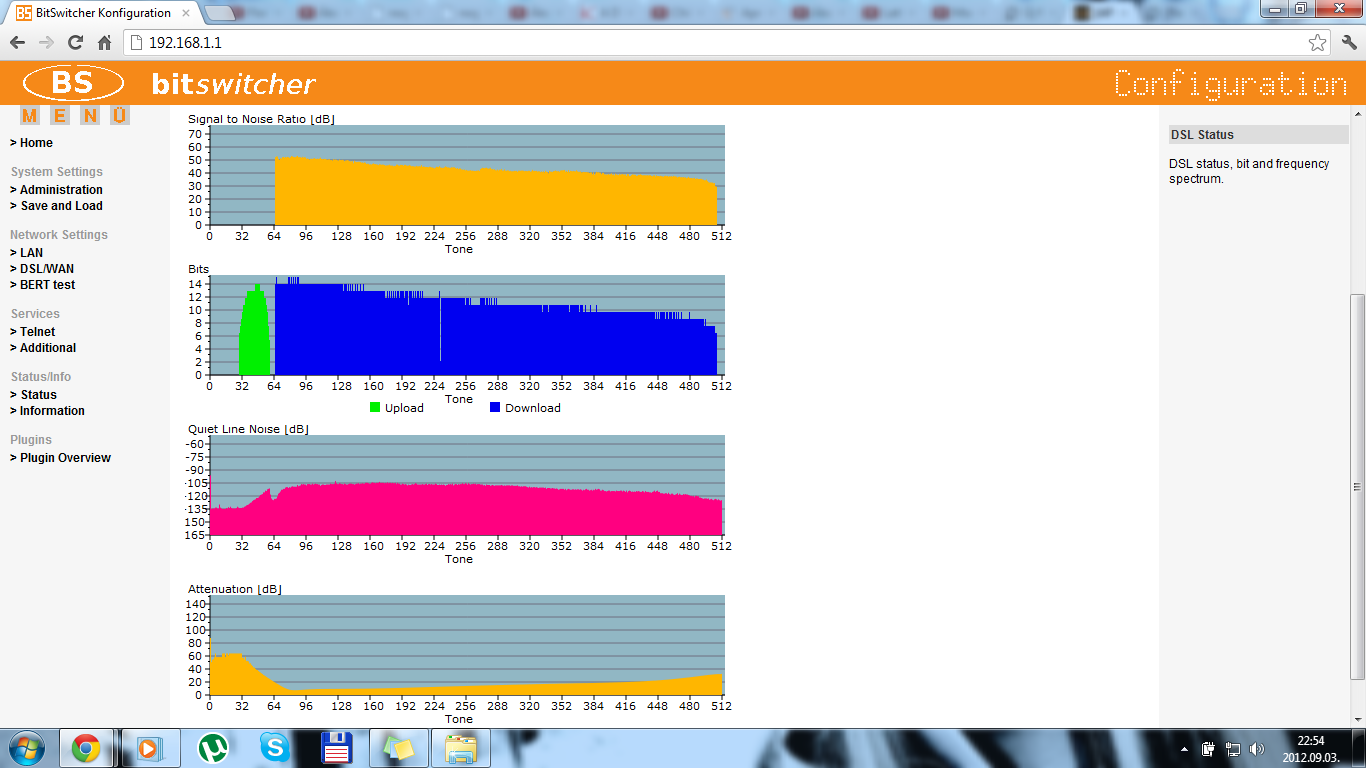

Jól látod a helyzetet: az ADSL nem szakad meg, hanem "csak" a PPPoE kapcsolat bomlik el.
Mivel a vonalad a spketurm képek alapján hibátlan és DSL szakadásod sem volt, erős a gyanúm, hogy a routereddel lehet probléma. Jellemzően egy-két típus nem bírja a torrent által generált sok párhuzamos TCP kapcsolatot.
Próbáld ki router nélkül közvetlenül a gépre dugva a modemet, hogy úgy is szakad-e.
Dchard
Szokenesz
Üdv.
Újra sikerült egy érdekes dolgot tapasztalnom... ha elkezdek torrentezni [legyen az le vagy feltöltés, mindegy] szakad a DSL, azaz újra kell csatlakoznom, de a modem felületén a "DSL uptime" sornál, már több, mint 600 óránál járok, tehát a DSL szinkron nem veszett el, akkor mégis mi a hiba? (Persze ha jól értelmezem a modem uptime sorát vagy nem csak szinkron vesztéssel tud szakadni?
) Tudok ez ellen tenni bármit is? -

N2O999
Az utóbbi napokban a 15 megás internetem 10-20 percenként meghal, bejelentettem az ügyfélszolgálaton, elvileg egy érpárcserét intéztek, de szerintem nem itt van a gond, mert azóta is ugyanaz a problémám.
Jelenleg egy öregecske, forrófejű 360R C3 modemet használok, de hétfőn egy T1 tulajdonosa leszek.
A vonali értékek szerintem egész jók, bár nem vagyok nagy szakértő, a hiba forrása az, hogy a hibajavítások száma hirtelen nagyon megugrik, majd dobja is a szinkronizációt.
A modem cseréje megoldja a problémát, vagy megint hívjam a szerelőt?
A T1 és a T1E modem között van különbség?Köszönöm a segítséget!
Itt a szinkronizáció után nem sokkal a helyzet
Itt már látszik a hibák nagy száma
dchard
vlaci79
#1436
A vonal hibátlannak tűnik, kicsit magas a csillapítás, de ennek az 5megás csomagnak mennie kellene hibátlanul.
Ha az új szűrő után is szakad, én visszakényszeríteném ADSL2 és/vagy sima ADSL(G.DMT) üzemmdóba és megnézném, hogy úgy is szakad-e.
Ha ez nem jön be, akkor SNR margin emelés 130%-ra.
Ha ez sem jön be, akkor a leírás szerint SNR monitorozást kell csinálni, hogy kiderüljön melyik vivők szórakoznak.
Bár a kép tanúsága szerint brutálisan nagy a tartalék, így még egy jelentős zajosodára sem kéne így reagálnia.
