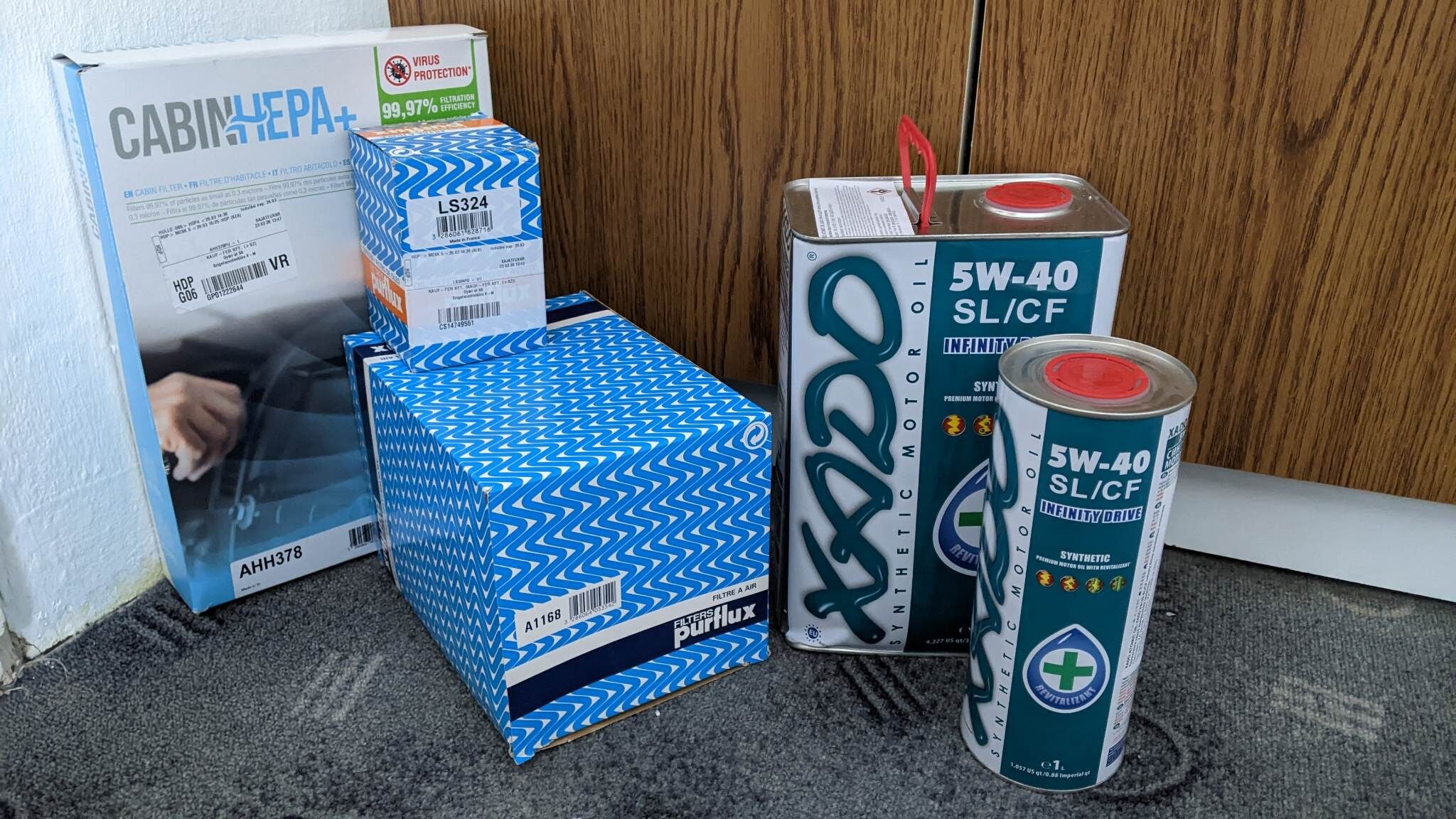

Havernak volt egy öreg Avensise, neki pl szépen gatyába rázta a motor olajzabálását a Xado. Én a gyakori és jó minőségű olajcserében hiszek de kinek mi. Bár ez nyilván csak akkor opció, ha az elejétől nálad van a kocsi.

Igen, ez nem egy rossz ötlet, nekem is eszembe jutott már. Mondjuk a Xado csapágy-visszaépítésében nem hiszek, a Liqui Moly szimpibb.

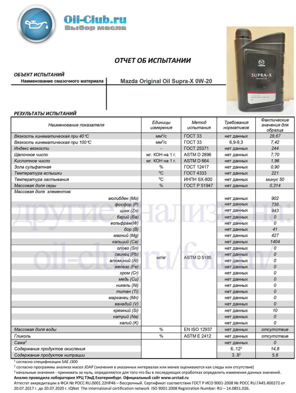

Asbee
Google fordító, de lényeg így is ok
1) The base number is average 7.7. This suggests that the oil will last for 5-7.5 thousand kilometers. Service intervals at the dealer are 15,000 kilometers. What does this mean? That you need to change your oil between official shifts. Either you go to the dealer yourself and demand that the oil be changed earlier, or you quietly change it yourself. This oil is not enough for such a long interval.
2) Viscosity at 40C = 28.67. Imagine, my classmates have 42, but here it’s 28.67. That is, we have before us an oil for setting fuel economy records. Perhaps this is generally the lowest-viscosity twenty that Oil Club has tested. By the way, take note for owners of hybrids. They were looking for just such an oil... The point is that low viscosity allows you to save fuel during cold starts and warming up to operating temperature. It has less resistance to engine parts...
3) Viscosity at 100C = 7.42. Also low. Also economical. Is it enough to protect against wear? If you have normal civilian operation without extreme conditions and an engine that is designed to use low viscosity. I think so. Everything will be OK.
4) Viscosity index 244. Very high. Once again it confirms that this is an economical oil.
5) Flash point 221C. Doesn't break any records. Let me explain why? Low viscosity base oils generally do not have a high flash point compared to thick base oils. And the more such base oils in a product, the worse its thermal stability. That’s why we don’t have enough stars in the sky, but there’s no need to worry about it, the minimum required is there.
6) Pour point -50C. My regards! Do I need to say something? No matter where you use it, it will hold up.
7) Sulfur is high, most classmates contain less sulfur. But later we will see a fattening additive package. She's most likely from there. The sulfate ash content is good, allowing this oil to be used in engines with direct injection.
8) Let's move on to the additive package. See that huge molybdenum content? Not only does Mazda save fuel with its low viscosity. There is also a powerful molybdenum complex present here, which performs two functions. Provide even more fuel economy and protect against wear in case of emergency cases of oil film rupture. Molybdenum coats the surfaces of parts and even if there is a decrease in viscosity or extreme loads, it will protect the engine. The oil contains boron as an ashless dispersant. Magnesium plus calcium as a detergent neutralizing additive. Well, phosphorus plus zinc, the traditional anti-wear additive ZDDP .
The Fourier IR spectrum indicates that the oil is based on VHVI hydrocracking (possibly adding PAO or is it VHVI III+ because the peak is high.)Ultra economical oil. Even Toyota doesn't have this. If you want to set fuel economy records. Try it. He has everything for this. Very low viscosity at the moment when you start the engine in the morning and drive short distances with chronic underheating. Lots of molybdenum to reduce friction and wear. Excellent low temperature performance. Anti LSPI calcium plus magnesium package. It is with this oil that SkyActive X will produce maximum power due to lower viscosity and molybdenum resistance. Mazdavodam who is going to pour it. Very important advice. Don’t think that it will last forever and last 15,000 km. It needs to be changed at least after 7.5 thousand km.

Megérkezett az olaj az olajlerakattól. [link]
Kicsit bizalmatlan voltam, ezért goggle maps-on megnéztem, tényleg van-e ott üzletük ( van), és adószámuk alapján ( az olajmarket és az olajlerakat egy adószámon van) az ecégjegyzéken ellenőriztem, létező cég problémák nélkül.
No, ezekután vasárnap rendeltem, hétfőn visszaigazolták, kedden ( ma) már meg is kaptam az árut.
Volt benne meglepi ajándék is! 1 db XL-es ( Fuchs matricás) Polo, Motulos lánctisztító kefe, szórófej, általános tisztító, Fuchs sebességváltó olaj prospektus.
