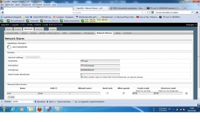

vargalex #24130 üzenetére
Köszönöm a segítséget!
Működik végre !
Hurrá így most már meg tudtam csinálni !

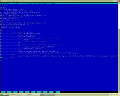

Egy db AP feleslegessé vált!Köszönöm !!! Most így néz(ek) ki :
Mar 8 01:27:09 OpenWrt authpriv.info dropbear[5726]: Exit (root): Exited normally
Mar 8 01:27:14 OpenWrt user.notice root: Wi-Fi radio is on.
Mar 8 01:27:14 OpenWrt kern.info kernel: [ 8755.780000] device wlan0 entered promiscuous mode
Mar 8 01:27:14 OpenWrt kern.info kernel: [ 8755.780000] br-lan: port 2(wlan0) entering forwarding state
Mar 8 01:27:14 OpenWrt kern.info kernel: [ 8755.790000] br-lan: port 2(wlan0) entering forwarding state
Mar 8 01:27:17 OpenWrt kern.info kernel: [ 8758.210000] device wlan0 left promiscuous mode
Mar 8 01:27:17 OpenWrt kern.info kernel: [ 8758.220000] br-lan: port 2(wlan0) entering forwarding state
Mar 8 01:27:17 OpenWrt kern.info kernel: [ 8758.350000] device wlan0 entered promiscuous mode
Mar 8 01:27:17 OpenWrt kern.info kernel: [ 8758.350000] br-lan: port 2(wlan0) entering forwarding state
Mar 8 01:27:17 OpenWrt kern.info kernel: [ 8758.360000] br-lan: port 2(wlan0) entering forwarding state
Mar 8 01:27:19 OpenWrt user.notice root: Wi-Fi radio is off.
Mar 8 01:27:19 OpenWrt kern.info kernel: [ 8761.080000] device wlan0 left promiscuous mode
Mar 8 01:27:19 OpenWrt kern.info kernel: [ 8761.080000] br-lan: port 2(wlan0) entering forwarding state
Mar 8 01:27:24 OpenWrt user.notice root: Wi-Fi radio is on.
Mar 8 01:27:24 OpenWrt kern.info kernel: [ 8765.900000] device wlan0 entered promiscuous mode
Mar 8 01:27:24 OpenWrt kern.info kernel: [ 8765.900000] br-lan: port 2(wlan0) entering forwarding state
Mar 8 01:27:24 OpenWrt kern.info kernel: [ 8765.910000] br-lan: port 2(wlan0) entering forwarding state
Mar 8 01:27:27 OpenWrt kern.info kernel: [ 8768.330000] device wlan0 left promiscuous mode
Mar 8 01:27:27 OpenWrt kern.info kernel: [ 8768.340000] br-lan: port 2(wlan0) entering forwarding state
Mar 8 01:27:27 OpenWrt kern.info kernel: [ 8768.470000] device wlan0 entered promiscuous mode
Mar 8 01:27:27 OpenWrt kern.info kernel: [ 8768.470000] br-lan: port 2(wlan0) entering forwarding state
Mar 8 01:27:27 OpenWrt kern.info kernel: [ 8768.480000] br-lan: port 2(wlan0) entering forwarding state
Mar 8 01:27:32 OpenWrt user.notice root: Wi-Fi radio is off.
Mar 8 01:27:32 OpenWrt kern.info kernel: [ 8773.940000] device wlan0 left promiscuous mode
Mar 8 01:27:32 OpenWrt kern.info kernel: [ 8773.940000] br-lan: port 2(wlan0) entering forwarding state--------------------------000000000000000000---------------------------------
[ 8773.940000] br-lan: port 2(wlan0) entering forwarding stateAhhoz , hogy a verkli elindíthatóvá (ill. először gombbal leállíthatóvá) váljon először Luciból engedélyezni kellett a Wifit.

vargalex
Hi!
Jobb lett volna, ha szövegként másolod ide, mert így néhol nem látszik rendesen, hogy van-e aposztróf, stb. A fő probléma az, hogy a led útvonala megváltozott, így a további kódot nem is futtatta le (pl. a log-ba sem került be). Viszont a QSS ledet felesleges kapcsolgatni, a WiFi led-et úgyis kapcsolja a driver. Illetve a @wifi-device[0] helyett lehet egyszerűen radio0-ként hivatkozni rá. Szóval helyesen (a QSS led kapcsolgatást javítottam, de megjegyzésbe tettem):
#!/bin/sh
if [ "$BUTTON" = "wps" ]; then
if [ "$ACTION" == "pressed" ]; then
WIFI_RADIOSTATUS=`uci -q get wireless.radio0.disabled`
if [ $WIFI_RADIOSTATUS == '1' ]; then
#echo 1 > /sys/class/leds/tp-link\:green\:qss/brightness && \
uci set wireless.radio0.disabled=0 && \
uci commit wireless && \
logger "Wi-Fi radio is on."
else
#echo 0 > /sys/class/leds/tp-link\:green\:qss/brightness && \
uci set wireless.radio0.disabled=1 && \
logger "Wi-Fi radio is off."
fi
wifi
fi
fi -
