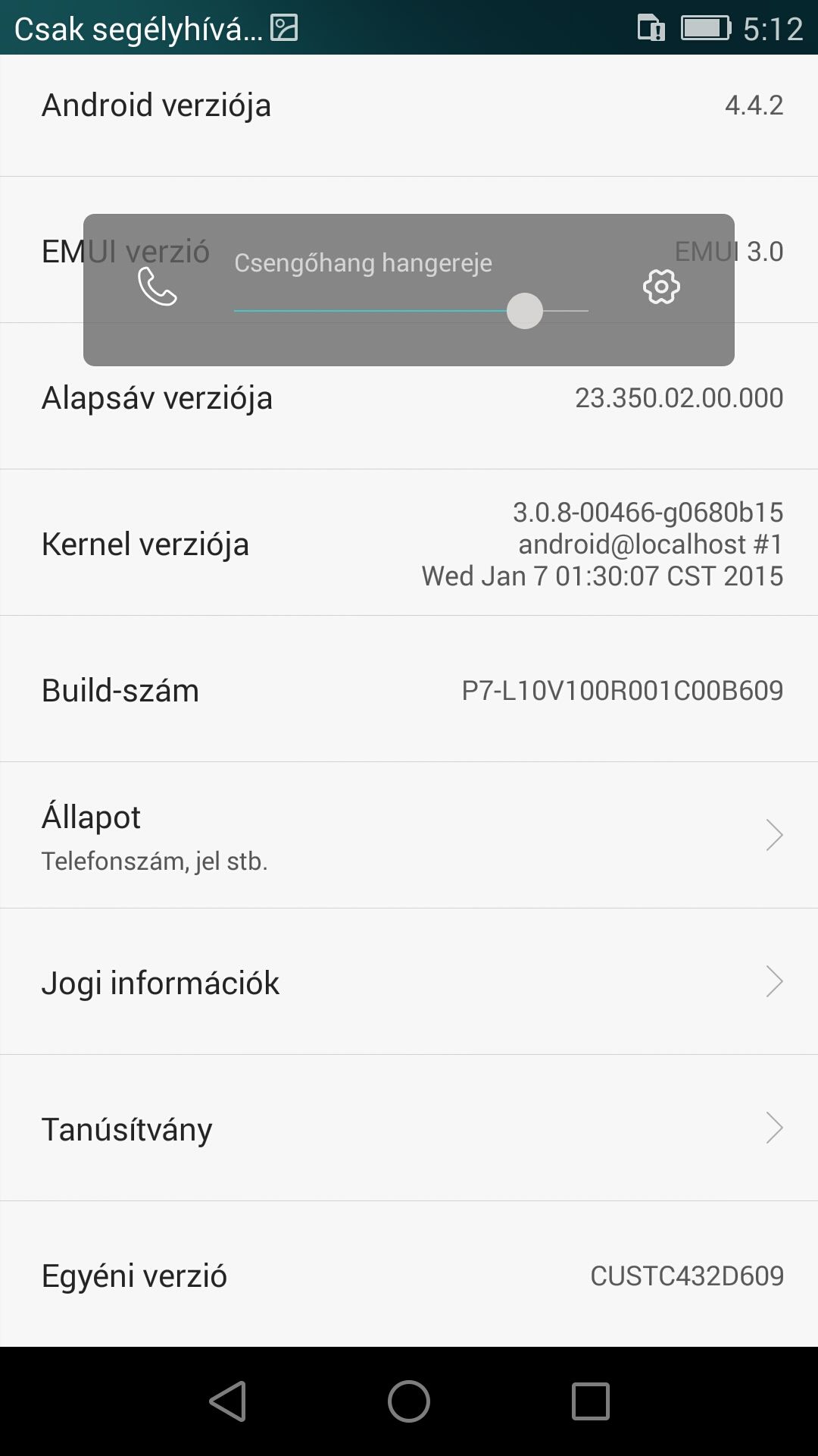

[Huawei P7 P7-L10C900B800-Transition_Pack]
[Sophia-L10_V100R001C00B609_Firmware_Europe_Android 4.4.2_EMUI 3.0]
Sophia-L10_V100R001C00B623_Firmware_Russian Region_Channel-Others_Android 4.4.2_
Elsőnek, az első romot. Ezután jöhet a B609.
