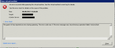

Tegnap kellett volna csinálnunk egy snapshot-ot az egyik rendszerünkről és a következő hibát kaptuk:
Ma is masszíroztuk a dolgot, néztük a logot amiben a következőek állnak:
2012-08-07T07:41:13.990Z| vmx| Vix: [854689 vigorCommands.c:511]: VigorSnapshotManager_Take: takeOptions=8, clientFlags=0, displayName=clone-temp-1344325273452675
2012-08-07T07:41:14.004Z| vmx| SnapshotVMX_TakeSnapshot start: 'clone-temp-1344325273452675', deviceState=0, logging=0, quiesced=1, native=0, sibling=0 cb=756FAC0, cbData=82437B0
2012-08-07T07:41:14.043Z| vmx| DISKLIB-VMFS : "/vmfs/volumes/4ecfa1fa-0b62cca8-49f4-001999991d06/GEPNEV/GEPNEV-flat.vmdk" : open successful (21) size = 107374182400, hd = 0. Type 3
2012-08-07T07:41:14.043Z| vmx| DISKLIB-VMFS : "/vmfs/volumes/4ecfa1fa-0b62cca8-49f4-001999991d06/GEPNEV/GEPNEV-flat.vmdk" : closed.
2012-08-07T07:41:14.053Z| vmx| DISKLIB-VMFS : "/vmfs/volumes/4ecfa1fa-0b62cca8-49f4-001999991d06/GEPNEV/GEPNEV_1-flat.vmdk" : open successful (21) size = 322122547200, hd = 0. Type 3
2012-08-07T07:41:14.053Z| vmx| DISKLIB-VMFS : "/vmfs/volumes/4ecfa1fa-0b62cca8-49f4-001999991d06/GEPNEV/GEPNEV_1-flat.vmdk" : closed.
2012-08-07T07:41:14.055Z| vcpu-1| ToolsBackup: changing quiesce state: IDLE -> STARTED
2012-08-07T07:41:22.227Z| vcpu-0| Msg_Post: Warning
2012-08-07T07:41:22.227Z| vcpu-0| [msg.snapshot.quiesce.vmerr] The guest OS has reported an error during quiescing.
2012-08-07T07:41:22.227Z| vcpu-0| --> The error code was: 5
2012-08-07T07:41:22.227Z| vcpu-0| --> The error message was: Asynchronous operation failed: VssSyncStart
2012-08-07T07:41:22.227Z| vcpu-0| ----------------------------------------
2012-08-07T07:41:22.233Z| vcpu-0| ToolsBackup: changing quiesce state: STARTED -> ERROR_WAIT
2012-08-07T07:41:24.227Z| vcpu-0| ToolsBackup: changing quiesce state: ERROR_WAIT -> IDLE
2012-08-07T07:41:24.227Z| vcpu-0| ToolsBackup: changing quiesce state: IDLE -> DONE
2012-08-07T07:41:24.228Z| vcpu-0| SnapshotVMXTakeSnapshotComplete done with snapshot 'clone-temp-1344325273452675': 0
2012-08-07T07:41:24.228Z| vcpu-0| SnapshotVMXTakeSnapshotComplete: Snapshot 0 failed: Failed to quiesce the virtual machine. (40).A gép egy Windows 2008 R2, 64 bites, a VMware Tools out-of-date. Találkozott már valaki hasonló hibával?
