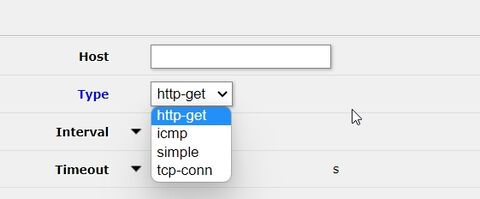

*) netwatch - added support for more advanced probing;
