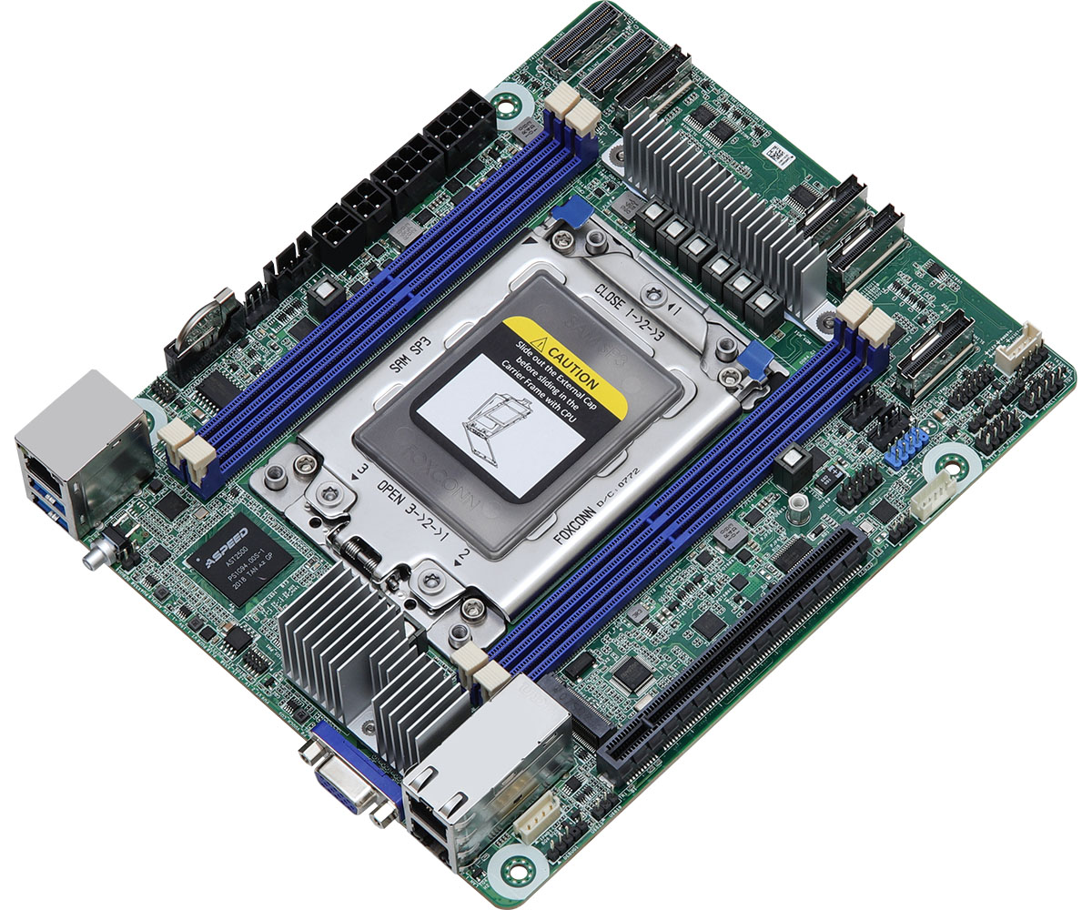

végre egy normális alaplap - ahol már kielégő a PCIe x16 slotok száma! ( 7 ! )WRX80 chipset [128 PCIe 4.0 Lanes, 8x DDR4 Memory, Socket sWRX8]
+ AMD Ryzen Threadripper PRO 3000
Gigabyte WRX80 SU8 with 8-channel memory for sWRX8 CPUs
https://videocardz.com/newz/gigabyte-wrx80-su8-motherboard-for-ryzen-threadripper-pro-pictured -
S_x96x_S

S_x96x_S
ASRock Rack ROMED4ID-2T Mini-ITX Motherboard For AMD EPYC Rome CPUs Launched, Supports Up To 64 Core & 128 Thread Chips
https://wccftech.com/asrock-rack-romed4id-2t-mini-itx-motherboard-for-amd-epyc-rome-cpus/https://www.asrockrack.com/general/productdetail.asp?Model=ROMED4ID-2T#Specifications
Proprietary (Deep mini-ITX)
4 DIMM
2 RJ45 (10GbE)
1 PCIe4.0 x 16.jpg)

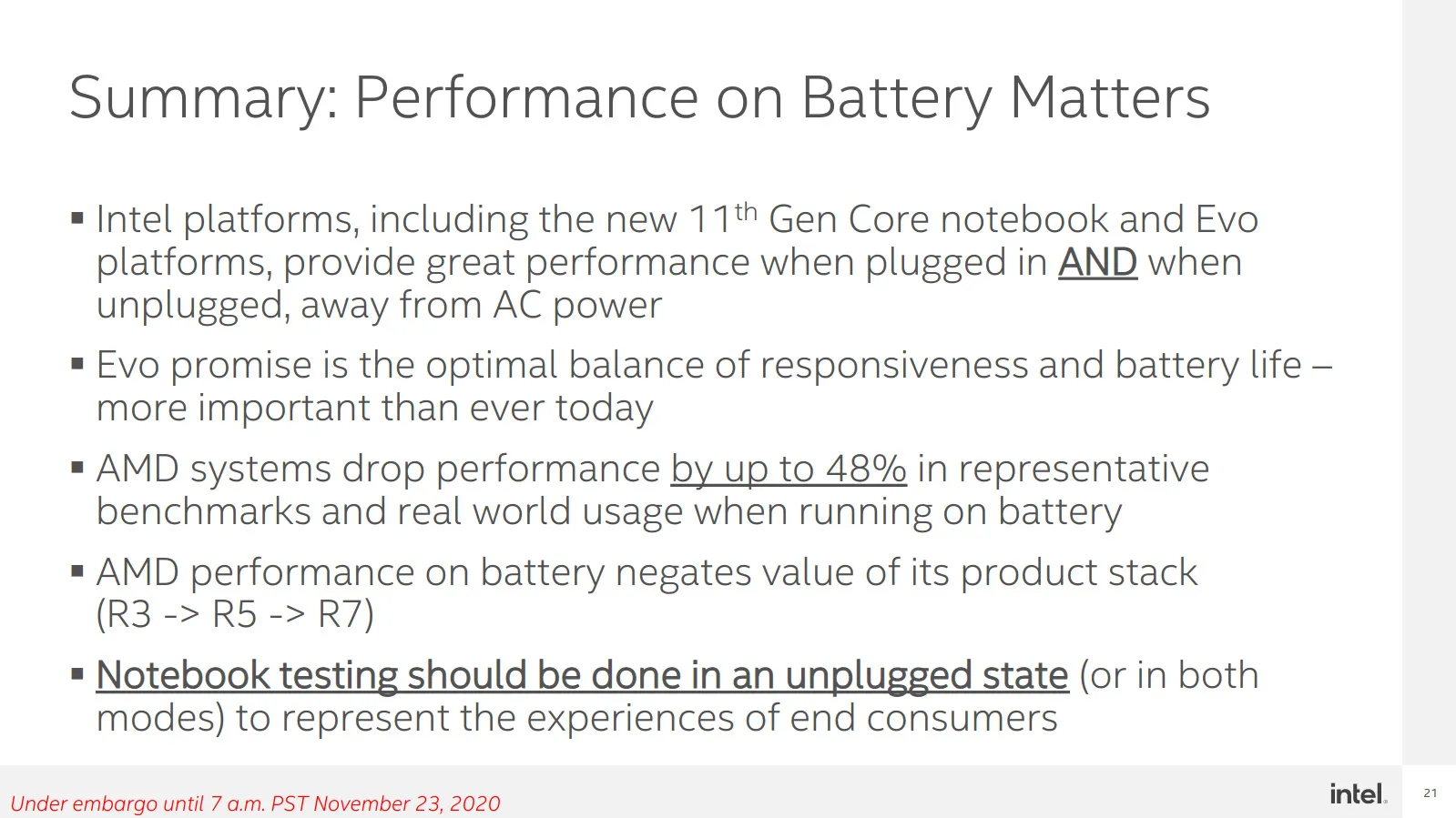

megtesztelte a Phoronix is az Intel állítását ..
( Ubuntu alatt ! vagyis ez Linux-os teszt )
[link]"So, long story short, in some cases the AMD Ryzen 5 4500U being tested did see more conservative clocking behavior when running on battery compared to AC power. It depended upon the particular workload though as to the relative hit and in some areas particularly with multi-threaded workloads the performance could come out around the same. In some of those multi-threaded workloads, the much cheaper Ryzen 5 4500U laptop was already outperforming the much pricier Intel Core i7 1165G7. The Dell XPS 13 notebook with i7-1165G7 in some workloads was seeing a performance hit on battery, but especially more so as the battery was diminished. Intel DPTF appears to cause the performance behavior to shift depending upon the battery level at which point it seems to severely keep the CPU down-clocked in order to extend the battery life rather than being more conservative on a full charge."
és pl. itt elég furcsa az akkus teljesítménye az Intelnek, pedig a PyBench az Intelnek kedvez.
( a 4500u még ZEN2-es mag )annyira nem rossz a Tiger Lake -se .. , de azért azt is kell még csiszolni.

#4404
Hát ez ugye nem meglepő fordulat
Ha valahogy, valamiben első tud lenni, akkor marketing szempontból ki KELL azt domborítani.
Most majd láthatjuk: amelyik oldal átveszi, hasonló komment nélkül, mint amit az ET tett, az részrehajló oldal. Nem néztek mögé, és nem vizsgálták meg a dolgot jobban
De ja, teszteljenek csak ACvel ÉS DCvel is. Láthatjuk ETnél, hogy nem olyan rossz a helyzet Ryzennél

Az ExtremeTech nem ért egyet az Intellel ..
Intel Is Spreading FUD About Supposedly Huge Ryzen 4000 Performance Drops on Battery https://www.extremetech.com/extreme/317657-intel-is-spreading-fud-about-supposedly-huge-ryzen-4000-performance-drops-on-battery
TESCO-Zsömle
Petykemano
#4402
Plusz ne akarjanak már beleszólni a független tesztelők módszereibe...
S_x96x_S
Intel beindította a TigerLake marketing gépezetet..
"Intel: AMD Weak On Battery-Powered Laptop Performance - But DPTF On Linux Still Sucks"
https://www.phoronix.com/scan.php?page=news_item&px=Intel-Battery-Performance"They basically promote that Intel Tiger Lake notebooks deliver better plugged/unplugged performance than AMD Ryzen systems... And they also were suggesting to reviewers that they do their notebook benchmarking in an unplugged state or otherwise test both modes."
