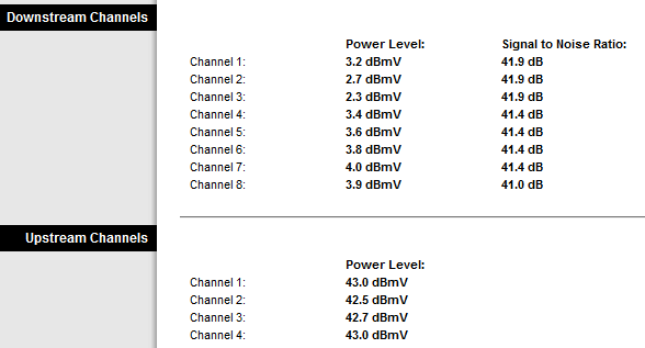

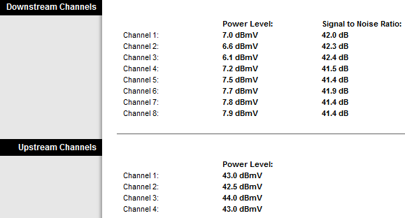

ownstream Channels
Power Level: Signal to Noise Ratio:
Channel 1: 6.4 dBmV 41.9 dB
Channel 2: 6.1 dBmV 41.9 dB
Channel 3: 5.6 dBmV 42.5 dB
Channel 4: 6.6 dBmV 41.4 dB
Channel 5: 6.9 dBmV 41.4 dB
Channel 6: 7.2 dBmV 41.5 dB
Channel 7: 7.3 dBmV 41.4 dB
Channel 8: 7.2 dBmV 41.3 dBUpstream Channels
Power Level:
Channel 1: 43.0 dBmV
Channel 2: 43.7 dBmV
Channel 3: 44.0 dBmV
Channel 4: 43.0 dBmV -
