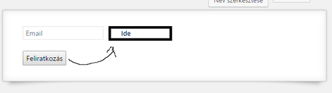

Rruuer
elvileg nem lehet szerkeszteni de ad egy html kódot
<!--START Scripts : this is the script part you can add to the header of your theme-->
<script type="text/javascript" src="http://rshop.rszerviz.hu/wp-includes/js/jquery/jquery.js?ver=2.7.5"></script>
<script type="text/javascript" src="http://rshop.rszerviz.hu/wp-content/plugins/wysija-newsletters/js/validate/languages/jquery.validationEngine-hu.js?ver=2.7.5"></script>
<script type="text/javascript" src="http://rshop.rszerviz.hu/wp-content/plugins/wysija-newsletters/js/validate/jquery.validationEngine.js?ver=2.7.5"></script>
<script type="text/javascript" src="http://rshop.rszerviz.hu/wp-content/plugins/wysija-newsletters/js/front-subscribers.js?ver=2.7.5"></script>
<script type="text/javascript">
/* <![CDATA[ */
var wysijaAJAX = {"action":"wysija_ajax","controller":"subscribers","ajaxurl":"http://rshop.rszerviz.hu/wp-admin/admin-ajax.php","loadingTrans":"Betöltés..."};
</script><script type="text/javascript" src="http://rshop.rszerviz.hu/wp-content/plugins/wysija-newsletters/js/front-subscribers.js?ver=2.7.5"></script>
<!--END Scripts-->
<div class="widget_wysija_cont html_wysija"><div id="msg-form-wysija-html5818bd4d33cee-1" class="wysija-msg ajax"></div><form id="form-wysija-html5818bd4d33cee-1" method="post" action="#wysija" class="widget_wysija html_wysija">
<p class="wysija-paragraph">
<input type="text" name="wysija[user][email]" class="wysija-input validate[required,custom[email]]" title="Email" placeholder="Email" value="" />
<span class="abs-req">
<input type="text" name="wysija[user][abs][email]" class="wysija-input validated[abs][email]" value="" />
</span>
</p>
<input class="wysija-submit wysija-submit-field" type="submit" value="Feliratkozás" />
<input type="hidden" name="form_id" value="1" />
<input type="hidden" name="action" value="save" />
<input type="hidden" name="controller" value="subscribers" />
<input type="hidden" value="1" name="wysija-page" />
<input type="hidden" name="wysija[user_list][list_ids]" value="1" />
</form></div>és ha kiveszem a </p> -t akkor jó lenne
<script src="http://rshop.rszerviz.hu/wp-includes/js/jquery/jquery.js?ver=2.7.5" type="text/javascript"></script>
<script src="http://rshop.rszerviz.hu/wp-content/plugins/wysija-newsletters/js/validate/languages/jquery.validationEngine-hu.js?ver=2.7.5" type="text/javascript"></script>
<script src="http://rshop.rszerviz.hu/wp-content/plugins/wysija-newsletters/js/validate/jquery.validationEngine.js?ver=2.7.5" type="text/javascript"></script>
<script src="http://rshop.rszerviz.hu/wp-content/plugins/wysija-newsletters/js/front-subscribers.js?ver=2.7.5" type="text/javascript"></script>
<script type="text/javascript">// <![CDATA[
// ]]></script>
<!--END Scripts-->
<div id="msg-form-wysija-html5818bd4d33cee-1" class="wysija-msg ajax"> </div>
<form id="form-wysija-html5818bd4d33cee-1" class="widget_wysija html_wysija" action="#wysija" method="post">
<p class="wysija-paragraph"><input class="wysija-input validate[required,custom[email]]" title="Email" name="wysija[user][email]" type="text" value="" placeholder="Email" /> <span class="abs-req"> <input class="wysija-input validated[abs][email]" name="wysija[user][abs][email]" type="text" value="" /> </span> <input class="wysija-submit wysija-submit-field" type="submit" value="Feliratkozás" /> <input name="form_id" type="hidden" value="1" /> <input name="action" type="hidden" value="save" /> <input name="controller" type="hidden" value="subscribers" /> <input name="wysija-page" type="hidden" value="1" /> <input name="wysija[user_list][list_ids]" type="hidden" value="1" /></p>
</form></div>de ha ezt a kódot beillesztem az oldal shortcode-hez ugyan úgy aláteszi, vagy én bénázok valamit?

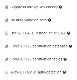

Köszi ismét a profi cikket: WPSZAKI.
Kipróbáltam, és szépen működött a költöztetés a végére, de kellett egy pici módosítást eszközölnöm a cikkhez képest, leírom, hátha bele szeretnéd írni.Mivel az adatbázis helyreállítás folyamatosan SQL Error #1071 -es hibát dobott bármit csináltam, kicsit utánanéztem a dolognak (pl. [link]), és kiderült, hogy az adatbázis kódolásával voltak gondok.
Ugye alapból pipa van az "Allow UTF8MB4 auto-detection" előtt, a fölötte levő 2 előtt pedig nem. Belenéztem a forrás oldal wp-config.php file-jába, ahol ez a sor szerepelt:
/** Database Charset to use in creating database tables. */
define('DB_CHARSET', 'utf8');Ezért kikapcsoltam az alsó opciót, a fölötte lévő kettőt pedig be, és azonnal sikerült az adatbázis helyreállítása.

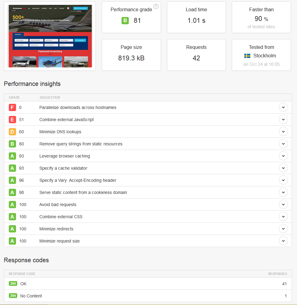

Magyar szolgáltatókban nem vagyok otthon. De talán ez és ez.
De ezek nem úgy tűnik hogy nagyon ki lennének hegyezve teljesítményre, és WP optimalizált lenne. De lehet tévedek, beszélni kell velük.Nem tudom mekkora havi összeget szánsz rá.
De ha kb. 40-50€/hó nem probléma, és esetleg alapszinten tudsz rendszergazdáskodni, vagy van haver aki segítene, akkor egy dedikált szerverrel + Plesk szerver management szoftverrel talán jobban járnál. -
hgabor19
Csak néhány most így hirtelen:
https://wpengine.com/
https://kinsta.com/
https://getflywheel.com/Azt is meg kell nézni, hogy ki a célközönség, hol a szerver, mekkora a ping a célterületről a szerverhez.
Ha több mint 80-100ms akkor CDN is fog kelleni.
De ha pl. csak európával operálsz akkor érdemes inkább európai szolgáltatót választani, és eu-n kívüli szervert kihagyni a játékból. -

Ilyen értékeket generál:
Piwik tracking OFF:
Gtmetrix
-PageSpeed 90%
-Yslow 81%
-Total page size: 557KB
-26 requestsPiwik tracking ON:
Gtmetrix
-PageSpeed 90%
-Yslow 81%
-Total page size: 799KB
-41 requestsPingdom tools
-PageSpeed 81%
-Total page size: 819KB
-42 requestsGtmetrixnél ekkora különbség hogy lehet a Piwik ON/OFF állapota között, mind page size és request tekintetében?
Pingdom meg gőzöm nincs miért mutat totál mást.
(képek file nevében van h van e vagy sincs követőkód a mért értékben) -
hgabor19
Arra van valami megoldás esetleg, hogy a Piwik követő kódja miért rontja le a "PageSpeed" értékeket?
(pedig async a követőkód)
Ha aktív a Piwik analitika, akkor nagyon gyengén muzsikál az oldal a Google felé.
Ha ki van kapcsolva, akkor helyre áll a rend.
Valaki tapasztalt hasonlót? -
