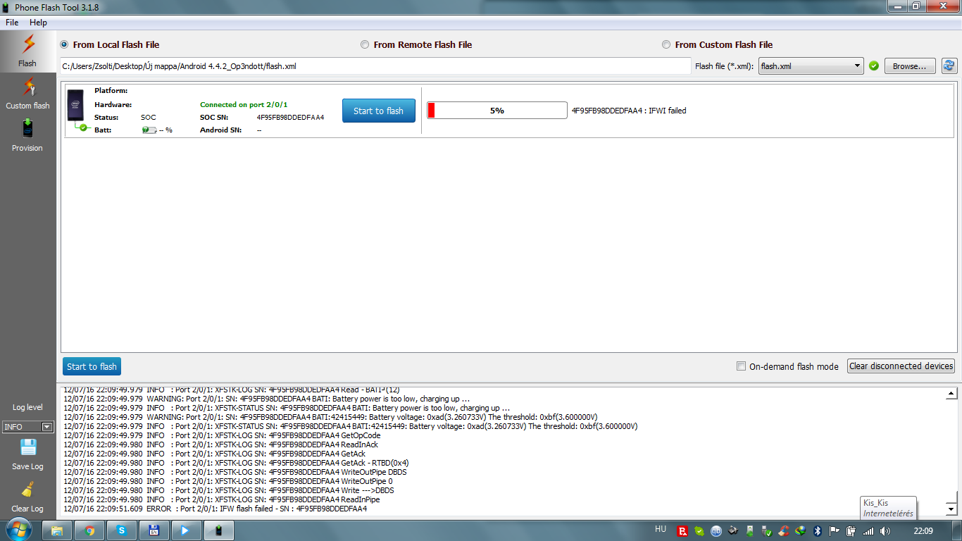

Felraktam töltésre, rádugtam ujra pár óra mulva, de ismét csak 5%ig megy a következőket irja:
12/08/16 13:24:35.377 INFO : Port 2/0/1: Start flashing BLANKPHONE flash file for
12/08/16 13:24:35.387 INFO : Port 2/0/1: IFW flash started - SN : 4F95FB98DDEDFAA4
12/08/16 13:24:35.579 INFO : Disabling xFSTK Misc DnX
12/08/16 13:24:35.579 INFO : Disabling xFSTK wipe out ifwi option
12/08/16 13:24:35.579 INFO : Using xFSTK Solo interface
12/08/16 13:24:35.579 INFO : xFSTK args(10):
12/08/16 13:24:35.579 INFO : C:/Users/Zsolti/Desktop/Új mappa/Android 4.4.2_Op3ndott/dnx_fwr.bin
12/08/16 13:24:35.579 INFO : C:/Users/Zsolti/Desktop/Új mappa/Android 4.4.2_Op3ndott/ifwi.bin
12/08/16 13:24:35.579 INFO : C:/Users/Zsolti/Desktop/Új mappa/Android 4.4.2_Op3ndott/dnx_osr.bin
12/08/16 13:24:35.579 INFO : C:/Users/Zsolti/Desktop/Új mappa/Android 4.4.2_Op3ndott/droidboot.img.POS.bin
12/08/16 13:24:35.579 INFO : 0x80000245
12/08/16 13:24:35.579 INFO : xFSTK Soft Fuse not set
12/08/16 13:24:35.579 INFO : XFSTK Downloader API 1.3.6.77
12/08/16 13:24:35.579 INFO : Copyright (c) 2012 Intel Corporation
12/08/16 13:24:35.579 INFO : fwdnx -- C:/Users/Zsolti/Desktop/Új mappa/Android 4.4.2_Op3ndott/dnx_fwr.bin
12/08/16 13:24:35.579 INFO : fwimage -- C:/Users/Zsolti/Desktop/Új mappa/Android 4.4.2_Op3ndott/ifwi.bin
12/08/16 13:24:35.579 INFO : osdnx -- C:/Users/Zsolti/Desktop/Új mappa/Android 4.4.2_Op3ndott/dnx_osr.bin
12/08/16 13:24:35.579 INFO : osimage -- C:/Users/Zsolti/Desktop/Új mappa/Android 4.4.2_Op3ndott/droidboot.img.POS.bin
12/08/16 13:24:35.579 INFO : gpflags -- 0x80000245
12/08/16 13:24:37.709 INFO : XFSTK-PROGRESS--0
12/08/16 13:24:37.709 INFO : XFSTK-STATUS--Detecting Intel Device - Attempt #0
12/08/16 13:24:37.709 INFO : XFSTK-PROGRESS--5
12/08/16 13:24:38.839 INFO : ....XFSTK-LOG--USBSN:--virtual bool CloverviewPlusDownloader::SetDevice(IGenericDevice*)
12/08/16 13:24:38.839 INFO : Initiating download...
12/08/16 13:24:38.839 INFO : XFSTK-LOG--USBSN:--virtual bool CloverviewPlusDownloader:
pdateTarget()
12/08/16 13:24:38.839 INFO : XFSTK-LOG--USBSN:--FWDnxPath -- C:/Users/Zsolti/Desktop/Új mappa/Android 4.4.2_Op3ndott/dnx_fwr.bin
12/08/16 13:24:38.839 INFO : XFSTK-LOG--USBSN:--FWImagePath -- C:/Users/Zsolti/Desktop/Új mappa/Android 4.4.2_Op3ndott/ifwi.bin
12/08/16 13:24:38.839 INFO : XFSTK-LOG--USBSN:--SoftfusesPath -- BLANK.bin
12/08/16 13:24:38.839 INFO : XFSTK-LOG--USBSN:--OSDnxPath -- C:/Users/Zsolti/Desktop/Új mappa/Android 4.4.2_Op3ndott/dnx_osr.bin
12/08/16 13:24:38.839 INFO : XFSTK-LOG--USBSN:--OSImagePath -- C:/Users/Zsolti/Desktop/Új mappa/Android 4.4.2_Op3ndott/droidboot.img.POS.bin
12/08/16 13:24:38.839 INFO : XFSTK-LOG--USBSN:--MiscDnxPath --
12/08/16 13:24:38.839 INFO : XFSTK-LOG--USBSN:--Gpflags -- 80000245
12/08/16 13:24:38.839 INFO : XFSTK-LOG--USBSN:--DebugLevel -- ffffffff
12/08/16 13:24:38.839 INFO : XFSTK-LOG--USBSN:--UsbDelay ms -- 0
12/08/16 13:24:38.839 INFO : XFSTK-LOG--USBSN:--TransferType -- USB
12/08/16 13:24:38.839 INFO : XFSTK-LOG--USBSN:--WipeIFWI -- False
12/08/16 13:24:38.839 INFO : XFSTK-LOG--USBSN:--Idrq -- False
12/08/16 13:24:38.839 INFO : XFSTK-LOG--USBSN:--Verbose -- True
12/08/16 13:24:38.839 INFO : XFSTK-LOG--USBSN:--void CloverviewPlusDownloader::Init()
12/08/16 13:24:38.839 INFO : XFSTK-LOG--USBSN:--Open
12/08/16 13:24:38.839 INFO : XFSTK-LOG--USBSN:--void CloverviewPlusUtils::SetUsbsn(char*)
12/08/16 13:24:38.839 INFO : Port 2/0/1: XFSTK-LOG SN: 4F95FB98DDEDFAA4 USB Device found - USBSN: 4F95FB98DDEDFAA4 Address:1
12/08/16 13:24:38.839 INFO : Port 2/0/1: XFSTK-LOG SN: 4F95FB98DDEDFAA4 void CloverviewPlusDownloader::do_update(CloverviewPlusOptions*)
12/08/16 13:24:38.839 INFO : Port 2/0/1: XFSTK-LOG SN: 4F95FB98DDEDFAA4 Start
12/08/16 13:24:38.839 INFO : Port 2/0/1: XFSTK-LOG SN: 4F95FB98DDEDFAA4 Sending DnER...
12/08/16 13:24:38.839 INFO : Port 2/0/1: XFSTK-LOG SN: 4F95FB98DDEDFAA4 WriteOutPipe DnER
12/08/16 13:24:38.839 INFO : Port 2/0/1: XFSTK-LOG SN: 4F95FB98DDEDFAA4 WriteOutPipe 0
12/08/16 13:24:38.839 INFO : Port 2/0/1: XFSTK-LOG SN: 4F95FB98DDEDFAA4 Write --->DnER
12/08/16 13:24:38.839 INFO : Port 2/0/1: XFSTK-LOG SN: 4F95FB98DDEDFAA4 GetOpCode
12/08/16 13:24:38.839 INFO : Port 2/0/1: XFSTK-LOG SN: 4F95FB98DDEDFAA4 ReadInAck
12/08/16 13:24:38.839 INFO : Port 2/0/1: XFSTK-LOG SN: 4F95FB98DDEDFAA4 GetAck
12/08/16 13:24:38.839 INFO : Port 2/0/1: XFSTK-LOG SN: 4F95FB98DDEDFAA4 GetAck - DFRM(0x4)
12/08/16 13:24:38.839 INFO : Port 2/0/1: XFSTK-LOG SN: 4F95FB98DDEDFAA4 FW: Handle virgin part DnX ...
12/08/16 13:24:38.839 INFO : Port 2/0/1: XFSTK-LOG SN: 4F95FB98DDEDFAA4 Changing to DLDR_STATE_FW_NORMAL ...
12/08/16 13:24:38.839 INFO : Port 2/0/1: XFSTK-LOG SN: 4F95FB98DDEDFAA4 InitNoSize
12/08/16 13:24:38.839 INFO : Port 2/0/1: XFSTK-LOG SN: 4F95FB98DDEDFAA4 CheckFile
12/08/16 13:24:38.839 INFO : Port 2/0/1: XFSTK-LOG SN: 4F95FB98DDEDFAA4 C:/Users/Zsolti/Desktop/Új mappa/Android 4.4.2_Op3ndott/dnx_fwr.bin size:99296 bytes
12/08/16 13:24:38.839 INFO : Port 2/0/1: XFSTK-LOG SN: 4F95FB98DDEDFAA4 InitFwImage
12/08/16 13:24:38.839 INFO : Port 2/0/1: XFSTK-LOG SN: 4F95FB98DDEDFAA4 C:/Users/Zsolti/Desktop/Új mappa/Android 4.4.2_Op3ndott/ifwi.bin size:2031600 bytes

12/08/16 13:25:23.709 ERROR : Port 2/0/1: IFW flash failed - SN : 4F95FB98DDEDFAA4Próbáltam másik portban, de ugyan ez fogad

Hát, sajnos nem sikerült, egyik módon sem tudtam feléleszteni. Egyre inkább hajlok arra, hogy vagy az usb porttal, vagy az akkuval van gond, mert az egyik frissítés közben ki is írta, hogy próbálja újraindítani de nem sikerül, töltsem fel az akkut. (Előtte egész éjszaka töltőn hagytam) Kérdés, hogy érdemes-e szétszednem, lehet-e hozzá alkatrészt kapni, vagy adjam el inkább alkatrésznek az egészet...

A fel-le csatlakozás nem feltétlen hiba! Többször is módot vált az USB kapcsolat pl. a flashtool alatt. Ameddig nem errorokat dobál, addig nincs baj... A bajok utána jönnek...
Nemsoká kissé frissül az összefoglaló. Volt itt-ott káosz benne az utóbbi években, most igyekeztem rendet tenni....

Az összefoglalóban keresd ezt a részt:
"Ha megvan nyissuk meg. Szükségünk lesz erre a fájlra is:
Teclast gyári rom"Na ez a link az, amit keresel. Viszont olvasd tovább is (azért nem linkelem most ide is), mert kicsit szerkeszteni kell az egyik fájlon!
Annyi még, hogy bootolni tud az utolsó szériás tableteen a Teclast rom is, de WiFi és egyéb gondok adódhatnak ezekkel is, ezért továbbra is javasolt visszatenni a gyári romot a felélesztés után!

Arra "vigyázz", hogy a Windows 8/ Windows 10 kerülendő, mert a driverek sem éppen frissek és a rendszer sem nagyon kezeli az USB portváltásokat éppen ebből kifolyólag. Inkább egy Win 7-es gépen kéne elkezdeni, ha mód van rá.

A 2 év garancia lejárta után pár héttel most úgy tűnik hogy meghalt a tablet. Korábban már párszor előadta, hogy csak a pörgő logóig jutott el, de akkor a factory reset mindig visszahozta, de most se kép, se hang. Töltést (a mérő szerint) úgy tűnik, hogy felveszi, de bekapcsolni nem lehet, a töltés ikon se jelenik meg.
Hangerő le + bekapcs. gomb nem segít, gépre kötve fel-le kapcsolódik, az eszközkezelőben CLOVERVIEW néven jelenik meg az Egyéb eszközök között, de drivert nem talál hozzá.
Lehet még megpróbálni valamit? Vagy kuka? Köszi... -

Írtam korábban: hagyd a flashtoolt békén! Úgyis újra KELL raknod a gyári romot a droidboot alól, mert a Teclast rom alatt nem vagy nem mindig megy pl. a wifi.
Szerintem maga a driver is, meg a bortányos minőséű USb csatlakozó is együtt közrejátszik ebben. A droidboot-ba beállva dugd a gépre > vagy fel sem csatlakozik, vagy le-fel dobálja. Következtetés: instabil szoftveres (driver) és hardveres kapcsolat (usb csati).

Megpróbáltam felrakni xp és win7 alól is.
5% nál nem megy tovább.
Ez a log: (sajnos nem tudom jelenleg máshogy betenni
).#PhoneFlashTool - Logs generated on 2016-10-30T22:07:05

Thowra123
Kaptam egy Op3n Dott W032i-C3 tabletet ami szoftveresen és talán hardveresen is rossz.
Semmi életjelet nem mutat (recovery sem), töltést mértem az akkun, az működik.
Phone flash tool 3.1.8 felismeri
Tud esetleg valaki linkelni egy működő romot amivel fel lehetne éleszteni? -
