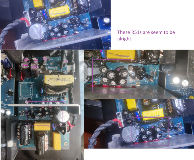

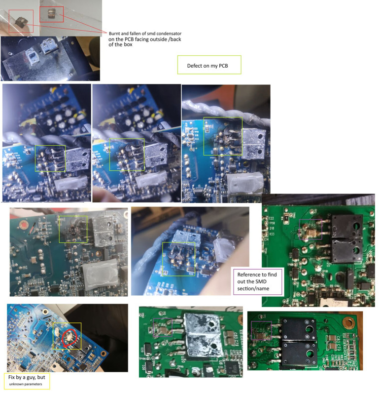

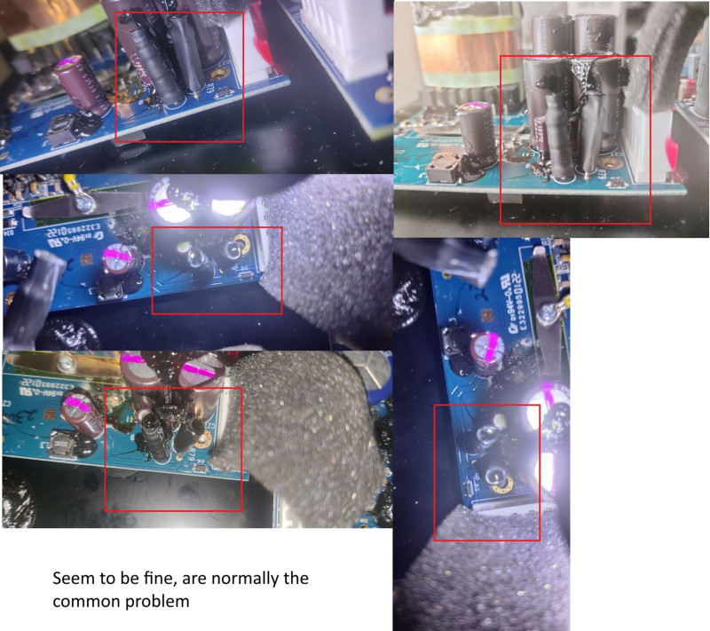

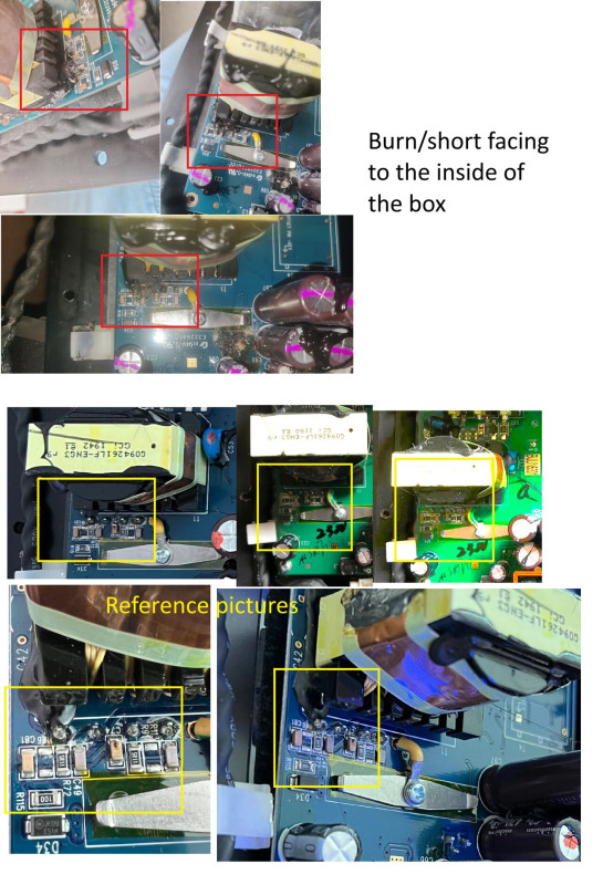

Hi everyone,
I'm trying to repair my Logitech Z906 subwoofer, which suddenly died right after switching it on.
There was a strong burnt plastic smell, and two input LEDs briefly flashed – then everything went completely dead.
When I opened the subwoofer, I found a badly burned SMD capacitor on the power supply board, next to a ferrite transformer labeled ER40.
The burn mark is visible on both sides of the PCB – maybe not fully burned through, but clearly damaged.
📌 What’s interesting:
This looks very similar to another post here, where C86 was burned, and possibly a MOSFET wasn't properly connected or failed, causing a chain reaction.
I suspect something similar happened in my case.
🛠️ Details:
Model: Logitech Z906
Revision: Latest version with blue PCB
Likely manufactured in 2022
Integrated PSU board, fixed inside the subwoofer
Board was always connected to power (standby for 1 year) before failure
Found capacitor based on comparison photos from a working board – but I don’t know the exact value/type
🧪 I plan to clean the board with spiritus (ethanol), not done yet.
🧰 Available Tools:
Soldering iron + hot air station
Solder sucker
UV-curing solder mask
Multimeter (no ESR meter)
Fine copper wire for trace repair
Cleaning supplies: spiritus, acetone, swabs, brushes
❓ Looking for help with:
Can someone with a Z906 measure or identify this capacitor? (same position as C86 in that other thread)
Is there a full schematic / part list for the PSU board?
How do I test MOSFETs, diodes or other components to be sure the failure didn’t go further?
Would a Hi-Fi repair shop be able to properly trace and repair this kind of PSU fault?
I’d really like to save this unit. The Z906 is Logitech’s flagship speaker system, on the market since 2011 and revised many times.
Since I have the latest version with blue PCB, I expected a reliable and refined product – not a catastrophic failure like this.
🙏 Any help (measurements, ID, repair tips, photos) would be greatly appreciated!
Thanks in advance!

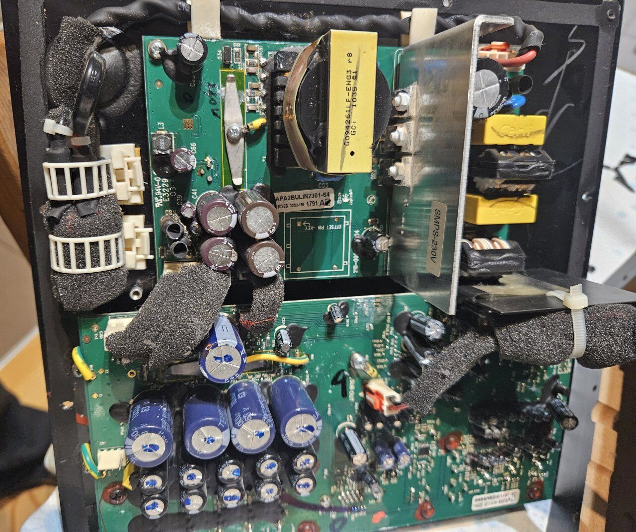

Idő közben sikerült megjavítania a kolegámnak. Egy kondenzátor égett szét a c86-os. Aztán működött, csak recsegve pattogva szolt a két front. Kiderült az egyik végfok IC-nek a kettő közül elengedett a forrasztása. Visszaforrasztotta azt is és most tesztüzem van.
Ezek lettek javítva rajta:
Esetleg,ha megkérdeznéd a kollégát milyen kondenzátor lett cserélve - az nagy segítség lenne.
Freezee
Nekem sajnos nincs ötletem, viszont kérdésem lenne. Milyen felhasználás mellett ment tönkre? Pár éve van nekem is ilyen, mérsékelt hangerőn van csak használva és nem is minden nap. Nagy terhelésnél/nagy hangerőnél következnek ezek be? Ugye az egyértelmű, hogy melegedési probléma van gyárilag ennél a cuccnál, a kérdés csak az, hogy azoknál is számítani kell az ilyesmire akik csak visszafogottan használják mint én?
Én 2013-14 ben vettem és azóta is napi használatban van. Semmi baja.
PedroStarr88
csendes újonc
