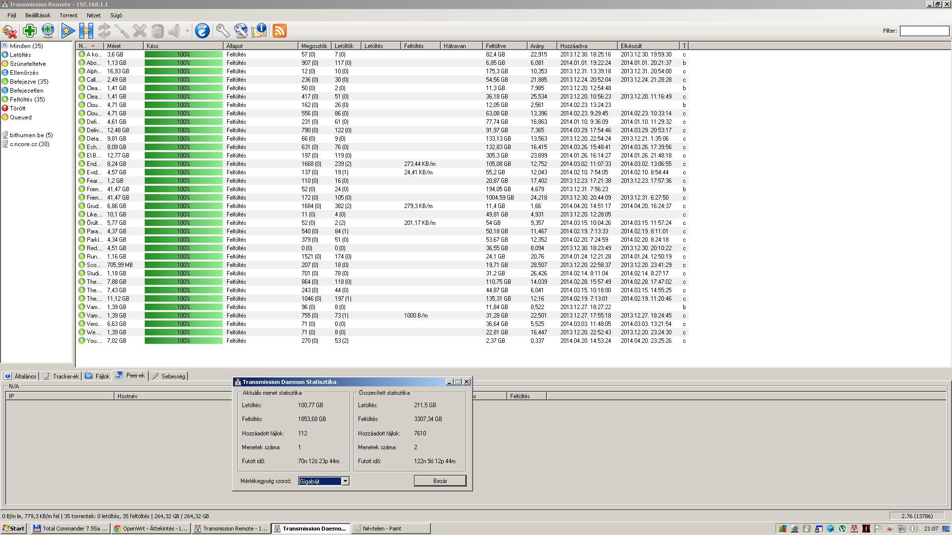

Jimcat
/dl/upc/2014-04/19/106408_dngyq91z3uegftmh_desktop_2014_04_19_10_43_50_829.jpg
