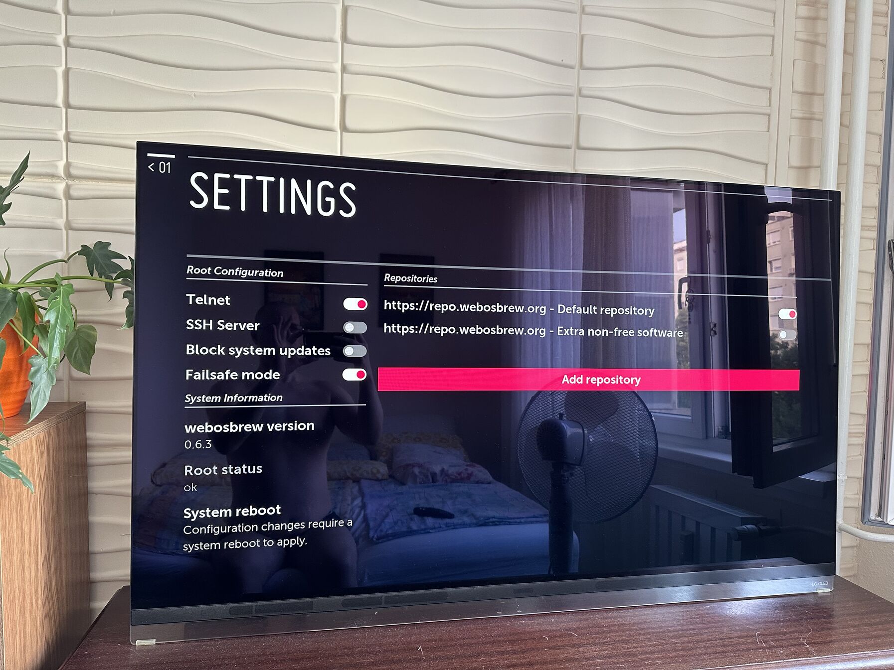

Sziasztok, búék mindenkinek, ha valakit esetleg érdekel akkor újabb LG-et lehet rootolni, nálam C2 és G4 esetében működik: [link]

Sziasztok, találtam a következő posztot a discordonaFAQ résznél, openlgtv alatt [link]
While installation via Homebrew Channel is mostly broken at the moment, there are other ways to install apps. Ez a része érthető.
Segítsetek értelmezni a mondatot:
Note: If you're reinstalling/updating Homebrew Channel itself and your TV is rooted, remember to elevate it after installing and before rebooting with
/media/developer/apps/usr/palm/services/org.webosbrew.hbchannel.service/elevate-service
.Jelenleg fel van telepítve a homebrew, ez automatikusan azt jelenti, hogy rootolva is van a TV készülék?
Elevetate it
micsodát, a tv készüléket? A linket hova kellene raknom, a pendrive-ra amiről telepítettem a homebrew-t?
Alternative ways to install apps: Using Dev Manager from another computer (currently does not run on phones).Using
ares-install
from the webOS CLI tools. It will upload the IPK from your machine to the TV and install it. You'll need to set up the device first withares-config
. Use thetv
profile. Note thatares-install
can be very unreliable and occasionally requires dozens of attempts before it works.Using the command line on the TV via SSH/telnet (or if you want to be fancy, serial). You can either download the IPK directly on the TV, as shown here (you'll need to know the URL of the IPK), or upload it from your computer/phone via SFTP (just skip thecurl
line and changeipkUrl
to wherever you uploaded it). You can hit control+C onceluna-send-pub
gets to theinstalled
(orfailed
) state, or you can wait for it to time out (15 seconds specified below; increase/remove this if you have an especially large app).curl -k -L -o /tmp/app.ipk '<URL goes here>' luna-send-pub -w 15000 -i 'luna://com.webos.appInstallService/dev/install' '{"id":"com.ares.defaultName","ipkUrl":"/tmp/app.ipk","subscribe":true}'

Szia, sikerült felrakni az E9-re, ezzel a módszerrel. C2-re nem megy, marad a github fórum

Rootoltam a tv-t a cikk alapján.Eddig minden rendben működött de most feldobál egy hibát:
Failsafe mode!Open telnet and remove/var/luna/preferences/webosbrew_failsafe
Tud valaki segíteni,hogy eltünjön a hibaablak? -
