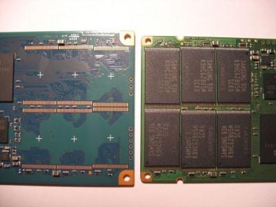

igen, ott lesz az!
irjak: ""Sleeve22, hope you'll have no problem, becasue I've managed to successfuly install full heigth mSATA drive (e.g. Samsung 840 EVO) to 3rd mini card slot (WWAN), which is visible only after removing base corner caps not just the base cover. After two weeks of testinting I can unquestionably confirm there is no problem to use mSATA drive on Latitude E6440. What a great notebook
es: "Yes, there is a mSATA slot in the E6440, though is not visible when taking the rear cover off. It needs the left bumper cap removed. It's situated above the WWAN marking as shown in the spoiler below. In fact, this slot is WLAN(PCIe1), mSATA (SATA3 port4) and WWAN (USB 2.0)!! Sharing the PCIe and SATA lines being a new Series-8 Flexible I/O chipset feature : Series-8 flexible USB3+PCIe or SATA+PCIe I/O -> some more x2 2.0 possibility"
itt (is): http://pt.community.dell.com/support-forums/notebooks/f/86/t/34094.aspxszerintem ez eleg egyertelmu, de a bizti kedveert rakerdezek a del supporton is.

en is kicsit elbizonytalanodtam, mert iponon es prohardveren is irjak, hogy nincs teljes meretu sata, de a hivatalos dell forumon, es egyeb kulfoldi notebook forumokon is azt talaltam, hogy bizony van, csak el van bujtatva:
irjak: "Nagy kár, hogy nincs teljes méretű mSATA bővítőhely (a Wi-Fié és a 3G modulé is feles), így a merevlemez mellé csak az optikai meghajtó helyére tehetünk SSD-t."
forras: http://prohardver.hu/teszt/14_huvelyk_dell_latitude_e6440_e7440_munka_vallala/belso.html
ugyanakkor: "I have tried and it works perfectly. I currently have an msata SSD as my main boot drive, and then have a smaller 2.5 SSD from a few years back for extra storage."
forras: http://en.community.dell.com/support-forums/laptop/f/3518/t/19568079.aspx
ezt is irjak: "Performance upgrade: mSATA SSD
itt: http://forum.techinferno.com/dell-latitude-vostro-precision/6980-14-dell-latitude-e6440-owners-lounge.html
tovabba: "mSATA csatlakozót nem találunk"
forras: https://ipon.hu/elemzesek/dell_latitude_e6440_korzo_vonalzo/2064/3ne most akkor kinek higgyek?

Ezt olvastam, de Notebookcheck és még egy-két oldal feltűnteni a Dell XT3-at msata kompatibilis eszközként. Akkor mind tévednének? Vagy csak a notebookcheck téved és msata mini ssd kéne a feles(half-size) kártya helyre? Találtam olyan bejegyzést is, ahol WWAN slotban vígan megy az SSD szintén dell gépen...

Most néztem ezeket az EC-s USB 3.0-ás adaptereket, és látom van belőle olyan is ami nem lóg ki a borításból, mert eddig ez is egy visszatartó erő volt. Amúgy nincs lehetőség esetleg egy moddolt BIOS-szal arra, hogy feloldja esetleg a SATA 2-es msata csatlakozót és SATA 3 sebességgel menjen? -

Egyébként stress teszt alatt nem ment 65fok föléu.i.: A 840 nagyon jó kis ssd, bár 19ért nem láttam még de megéri az árát mindenképp. Ha esetleg nagyon előre tervezel akkor vehetsz msata-s ssd-t ahhoz 1 adaptert így tudod használni 2,5ös helyen is és ha esetleg új gépet veszel majd akkor nem kell megint új ssd-t venni, bár ez nagyon előrehaladott gondolkodásmód. addig még rengeteg minden változhat, főleg hogy már jönnek az új csatolófüleletes ssd-k
