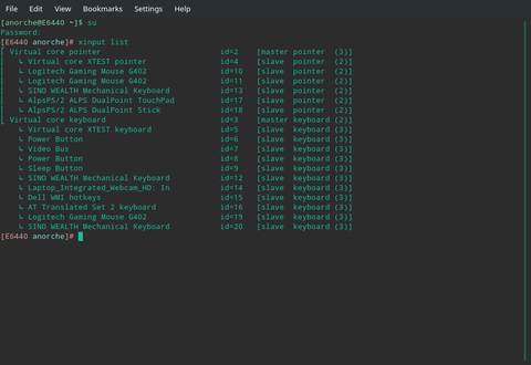

anorche1

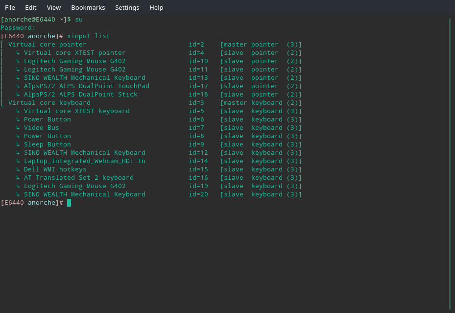

anorche1
Manjarot hasznalok, ott alapbol fel van rakva. Ahogy olvasom, nem ezzel lesz a gond, hanem a kernellel.
"Finally I have found a solution.
The intel_pstate driver has some problem with some Intel Hswell and later processors. Arch Linux users have noticed that this is the intel_pstate and the kernels internal timer problem. When timer is set to 300Hz (the default in arch) the intel_pstate driver is to sensitive. In Ubuntu this timer is set to 250Hz in a generic kernels.
When I test the linux-lowlatency kernel (whitch has set CONFIG_HZ to 1000) the problem seems to disappear (seems, because I have tested this in 4.11 lowlatency kernel and solution do not solve this problem). Battery lifetime increase from 2.5 to 4.5 hours for chrome html5video decoding. "
Hogyan tudnam modositani ezt a legegyszerubben a kernelben?
