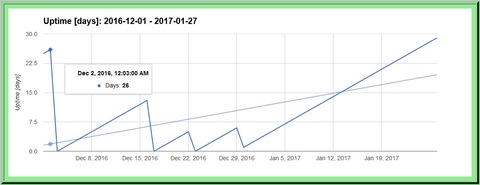

vizsgáld meg a böngésző-ben lefutó <script>-eket és keresd azt ahol az adatbázist küldi el, keress benne anomáliát...
function drawChart(){a=google.visualization.arrayToDataTable([['Time','Outside','Bedroom - 1','Bedroom - 2','Living room'],[new Date(2017,0,26,00,00),-0.38,23.06,21.13,22.75],
[new Date(2017,0,26,00,05),-0.38,23.06,21.06,22.69],
[new Date(2017,0,26,00,10),-0.50,23.06,21.06,22.63],
[new Date(2017,0,26,00,15),-0.69,23.13,21.00,22.63],
[new Date(2017,0,26,00,20),-0.69,23.13,21.00,22.56],
[new Date(2017,0,26,00,25),-0.50,23.06,21.00,22.56],
[new Date(2017,0,26,00,30),-0.50,23.13,20.94,22.56],
[new Date(2017,0,26,00,35),-0.44,23.06,21.00,22.50],
[new Date(2017,0,26,00,40),-0.50,23.13,21.00,22.50],
[new Date(2017,0,26,00,45),-0.38,23.13,21.00,22.50],
[new Date(2017,0,26,00,50),-0.50,23.13,21.00,22.44],
[new Date(2017,0,26,00,55),-0.56,23.13,20.94,22.44],ilyennek kell lennie...

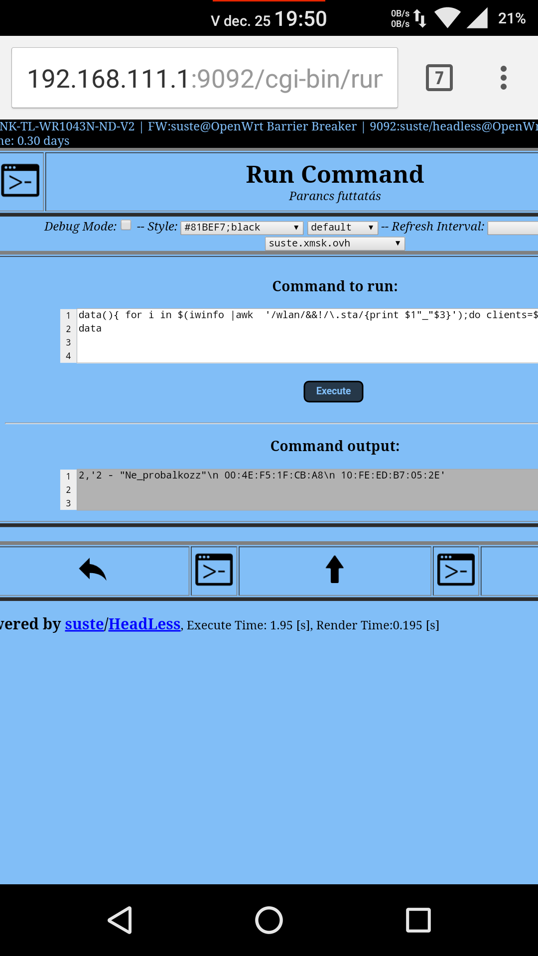

Így?
data(){ for i in $(iwinfo |awk '/wlan/&&!/\.sta/{print $1"_"$3}');do clients=$(iwinfo $(echo $i |cut -d_ -f1) assoclist |egrep -o "..:..:..:..:..:.." |awk '{nm="";"awk \x27/"tolower($1)"/{print $4}\x27 /tmp/dhcp.leases"|getline nm;if(!nm)nm=$1;printf nm"\\n"}' |sed "s/..$//");sumc=$(echo -e "$clients" |grep -v "^$" |awk 'END{printf NR}');sum=$(($sum+$sumc));sums="$sums\\n$sumc - $(echo $i |cut -d_ -f2-)\\n $clients";done;echo "$sum,'$sums'";}
Headless
poffsoft #1497 üzenetére
data(){ for i in $(iwinfo |awk '/wlan/&&!/\.sta/{print $1"_"$3}');do clients=$(iwinfo $(echo $i |cut -d_ -f1) assoclist |egrep -o "..:..:..:..:..:.." |awk '{nm="";"awk \x27/"tolower($1)"/{print $4}\x27 /tmp/dhcp.leases"|getline nm;if(!nm)nm=$1;printf nm"\\n"}' |sed "s/..$//");sumc=$(echo -e "$clients" |awk 'END{printf NR}');sum=$(($sum+$sumc));sums="$sums$sumc - $(echo $i |cut -d_ -f2-)\\n $clients\\n";done;echo "$sum,'$sums'";}
Csak dhcp listából néz nem nslookup…
