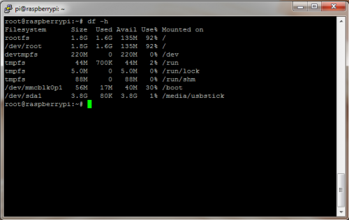

dabadab #5141 üzenetére
Nem hiszem
pi@raspberrypi / $ df -h
Filesystem Size Used Avail Use% Mounted on
rootfs 3.6G 2.0G 1.4G 59% /
/dev/root 3.6G 2.0G 1.4G 59% /
devtmpfs 220M 0 220M 0% /dev
tmpfs 44M 740K 44M 2% /run
tmpfs 5.0M 0 5.0M 0% /run/lock
tmpfs 88M 0 88M 0% /run/shm
/dev/mmcblk0p1 56M 17M 40M 30% /boot
/dev/sda1 3.8G 135M 3.6G 4% /media/usbstick -
