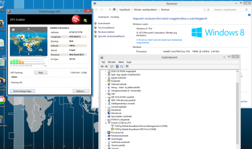

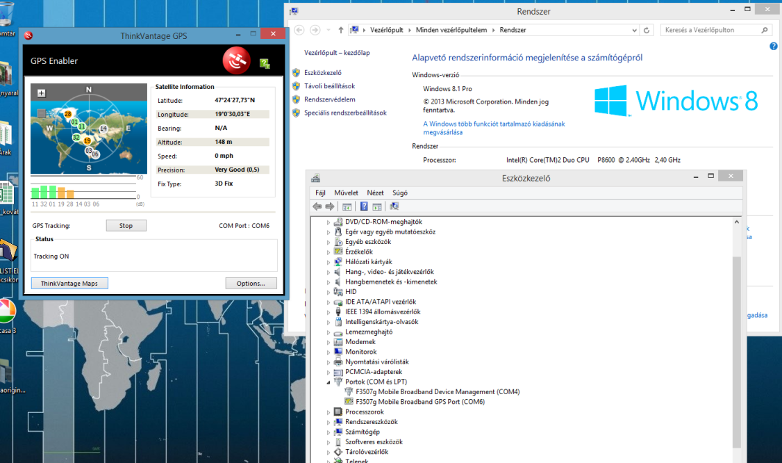

Használ valaki T400-ason Linuxot? Tudja e használni az ujjlenyomat olvasót? -
icoj69
Francia91 #52297 üzenetére
Nekem ugyan ez a 3G/GPS van a T400_asomban, Win 8.1 -et használok. Tökéletesen müködik+
Így csináld:
http://www.bibble-it.com/2012/03/17/f5521gw-wwan-install-on-windows-8-cp-lenovo-x220t -

icoj69
btudos #51734 üzenetére
ezt találtam:
I was able to install successfully the Wwan drivers under windows 8 for the X200T (Ericsson F3507g) - thanks to Ben Lee, who pointed me in the right direction with his X220T (Ericsson F5521GW – see http://www.bibble-it.com/2012/03/17/f55 ... novo-x220t).1. Uninstall all previous drivers for the wwan card (under programs or device manager).
2. Download the latest working drivers for windows 7.
IMPORTANT for the Ericson F3507g: I took the Ericsson F5521gw/F3607gw Wireless WAN Drivers, but not the latest version, because after version 6.3.3.6 (83Wo12WW), it was the end of support for the following thinkpad models:
• ThinkPad L410,L510
• ThinkPad SL300,SL400,SL400c,SL410,SL500,SL500c,SL510
• ThinkPad T400,T400s,T500
• ThinkPad W500
• ThinkPad X200,X200s,X200 Tablet,X301
So be sure to use for those models the version 6.3.3.6 that you can find here: http://download.lenovo.com/ibmdl/pub/pc ... wo12ww.exe
3. Click to install the drivers. After unzipping, don’t start setup!
4. Go to C:\DRIVERS\WIN\WWANER, where the files were unzipped.
5. Right click on setup.exe, choose properties, open compatibility tab, Change settings for all users, and set “Run this program” as “Windows 7” then apply.
6. Now run a command prompt as administrator (just type cmd on the start screen, right click, run as administrator option is at the bottom of the screen).
7. Type “cd \”
8. Type "cd C:\DRIVERS\WIN\WWANER”
9. Type “setup.exe /wNOAUTOSENSING /Wuselastknownradiostate”
10. When finished, you’ll find the mobile broadband icon listed, and you will be able to connect.To anyone who is considering the upgrade to Windows 8. I did a clean install, and most worked out of the box, partly after updates from Lenovo update (ThinkVantage System Update) except:
- Fingerprint software: resolved as Tim mentioned elsewhere on this forum by installing the software under Control Panel - Biometric Devices and enroll Authen Tec
- Camera: installed the windows 7 drivers (setup.exe with windows 7 compability)
- Pen/touch drivers: installed the windows 7 drivers (setup.exe with windows 7 compability)
- Bluetooth: I was able to get bluetooth working after installing the windows 7 hotkey package (as always, with windows 7 compability). The fn F5 key only works on the desktop (not on metro).azt hiszem neki állok win 8-at telepiteni
