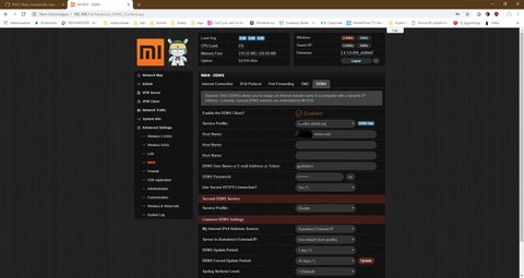

fireqpeg
Tessék ittvan és működik:
Sep 12 11:26:56 inadyn[571]: Resolving hostname fireqpeg.mooo.com => IP# 84.236.114.34
Sep 12 11:26:56 inadyn[571]: Checking for IP# change, connecting to checkip.dyndns.org (216.146.38.70:80)
Sep 12 11:26:57 inadyn[571]: Current public IP# 84.236.97.199
Sep 12 11:26:57 inadyn[571]: Update needed for alias fireqpeg.mooo.com, new IP# 84.236.97.199
Sep 12 11:26:57 inadyn[571]: Sending IP# update to DDNS server, connecting to freedns.afraid.org (50.23.197.94:443)
Sep 12 11:26:57 inadyn[571]: SSL connection using ECDHE-RSA-AES128-GCM-SHA256
Sep 12 11:26:57 inadyn[571]: Sending update URL query, connecting to freedns.afraid.org (50.23.197.94:443)
Sep 12 11:26:58 inadyn[571]: SSL connection using ECDHE-RSA-AES128-GCM-SHA256
Sep 12 11:26:58 inadyn[571]: Successful alias table update for fireqpeg.mooo.com => new IP# 84.236.97.199 -
