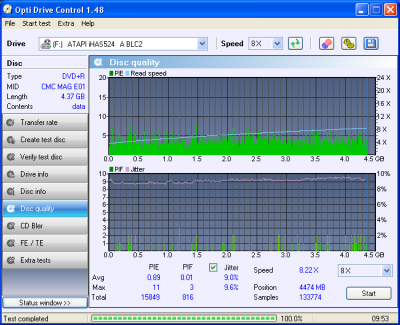

Ricoh Silver 8X DVD+R DL
Liteon Ihas 624B
@ 8x -
