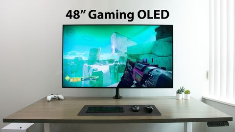

David Zhang: The Ultimate Small TV, Big Gaming Monitor | LG CX 48-Inch 4K OLED
