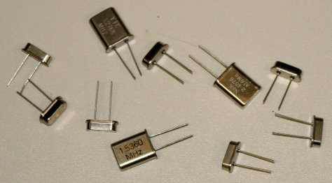

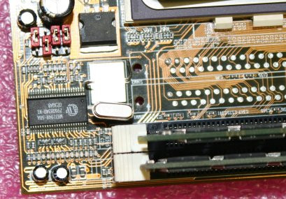

The reference clock was running on 14.31818MHz, but fortunately I had more than a dozen crystals in talon.
kristalyok

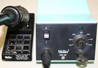

I warmed up the Weller and attacked the mainboard. I soldered a 1MHz crystal into the main board.
I was not so happy, because it was a fail. It was too slow, so the oscillator or the bus was not able to handle such reduction. After several replaced crystal I found 10MHz suitable. It meant 46MHz FSB instead of 66MHz. Not bad, but I was (and I am still) not satisfied.

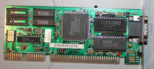

The last idea was to find a 6x86MX and Pentium 75 capable board. Pentium 75 meant 50MHz FSB, so it could be reduced more, than my board. The slowest FSB of my VIA is 66MHz. My friend has tons of old boards. After a short rummage he lent me an Aristo board, 16MB SDRAM and a brutal Trident 9000D
I was not lucky again. The BIOS of Aristo 5VIA5S is not compatible with Windows 7. It has some ACPI problem. However the 16MB module and the 256kb Trident gave me something to think of.

VGA: Trident 9000B 256kB

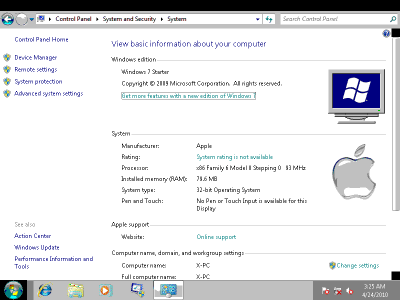

OS: Win7 Starter

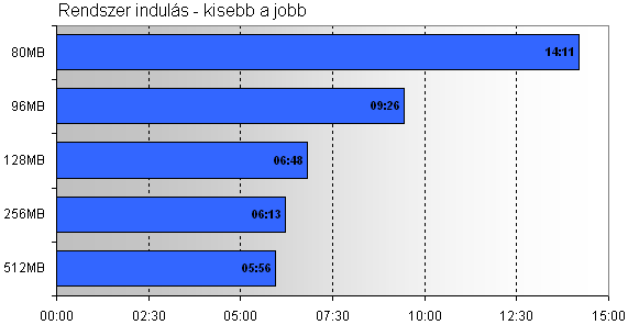

Below you can see a quick measurement how the startup depends on memory size. The clock started at Windows loader screen and finished whe the sart menu rolled over. It does mean I was able to navigate in Start menu after few minutes, but it never finished swapping.

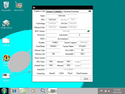

The second run was a quick GPU-Z. It was not able to identify TVGA9000. The resolution was an amazing 640x480 with 16 colours.

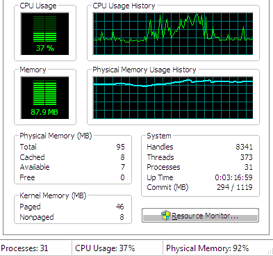

You can see below the CPU utilization when the system is loading control panel. The HDD swapped like crazy even if there was no load. At that stage the system had 96MB of memory.

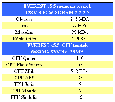

You may not believe, but I was able to start IE and download Everest. The install finished after 5min 46 sec. After the installer had finished I started the test and went for dinner. The results were not bad as the Cyrix CPU is "strong" in integer.
